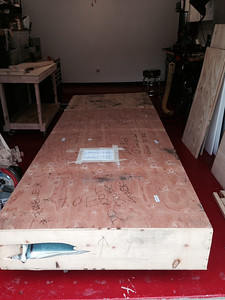

Got my tail kit today from Ron, very excited to start the build but I will be gathering some more tools and doing the practice kits before I touch the Tail Kit.
Good thing that there was a hole so it could breath... :eek:

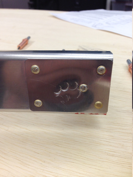

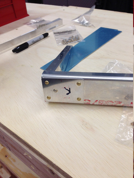

I started on the control surface today... It was very educational. :)
Made some mistakes, but that is the purpose of the practice kit, right? Didn't have the right pressure for the rivet gun, dropped the skin once, drilled out some rivets, etc...

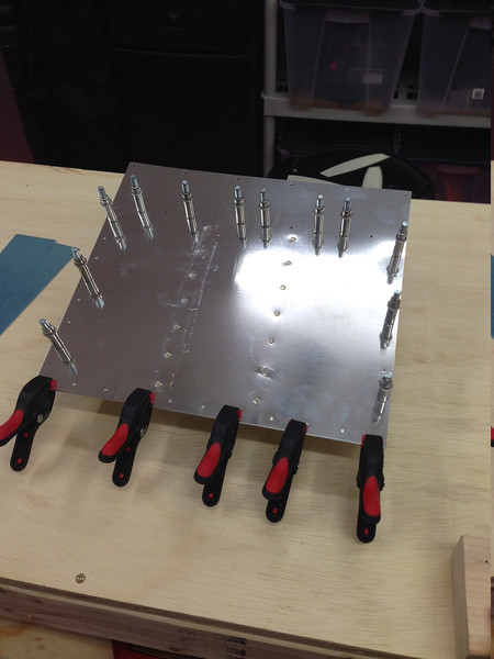

About half done.
Love the squeezer!
Opps! Too much pressure!
Novice move
Don't make the novice move I did in under dimpling
The horizontal stab. Use a firm blow with the hammer on a solid surface.
Don't use cheap dimple dies. Your skins should have clean crisp
Dimples with NO deflection around the dimple. If you under dimple, you
will get deflection. I thought I had used to much pressure on the rivet gun
Causing the deflection. Not the case. Flat skins will make you look and feel like a pro. Down load the rivet spec sheet from the Vans site. Use a 1,000 caliper to measure the shop head height and diam. Don't get tricked by rivet gauges.
They measure the mean. Not the min or max.
John,
You might try clamping your work to the bench to keep it stable for riveting. Chasing an assembly around on the bench with either a squeezer or rivet gun almost never ends well.;)
