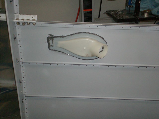

Here's pic after I installed mine.
No issues interfering with the right side static port that I've been able to notice.
That's good news. Although I may still install in the lower panel because there's a "divot" there that probably happened when I moved the tail cone from it's original home to mine a couple of years ago. I just remembered that when I went to look at it after your post.
