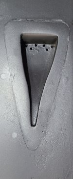

Yes, I made my own modified fuel vents. Based somewhat on airbus design. I made the "rocket" coil in the wing root and connect the end to the flush vent mounted to the lower side of the wing root fairing. They work well. As of yesterday, 387 hours.
Never liked the tube and it is prone to icing. Also with the submerged vent I could drill many very small holes in the back end to keep the insects out.
I bought a wind tunnel and validated the design against the std plans bent 1/4 tube, same manometer reading. Of course, only when the tube was directly in the wind stream. At an angle, the submerged retained the same value, the tube did not. I made a plug for a mold, and have it in the hangar somewhere.
Photo of my fuel vent installed on lower wing root fairing and one out of the mold, before trimming and installing plenum.

I did a LOT of research into fuel vents (see my Kitplanes article July 2011). Although "NACA vents" were originally designed as submerged inlets for jet engine intakes, they proved to be not as effective as the ram type engine intakes we see today, for example on fighters. However, NACA did extensive testing on this shape of vent for fuel vents (NACA Research Memorandum RM E8A27b March 29 1948, NACA Research Memorandum RM E8B05a March 20 1948 and NACA Research Memorandum RME8C05 April 23 A948). They were tested at various angles of attack and also in icing conditions. They are highly recommended as a low drag icing resistant fuel vent. Although they are used as fuel vents on airliners (M ~ 0.7 to 0.8), they are also used extensively on general aviation aircraft including experimental amateur build.
The principal of operation of using the ogive plan view shape to create a vortex and draw in free stream air of course works with a flow in the throat of the vent. But the shape is surprisingly effective with almost zero flow when acting as a fuel vent. In this application, because it is submerged, it is also very effective against icing when properly placed on the airframe.
