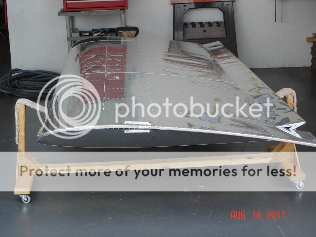

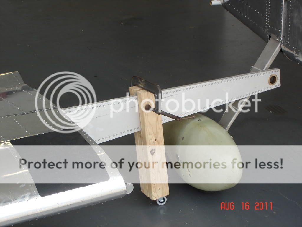

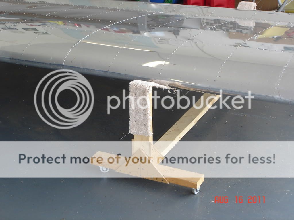

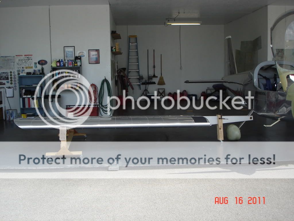

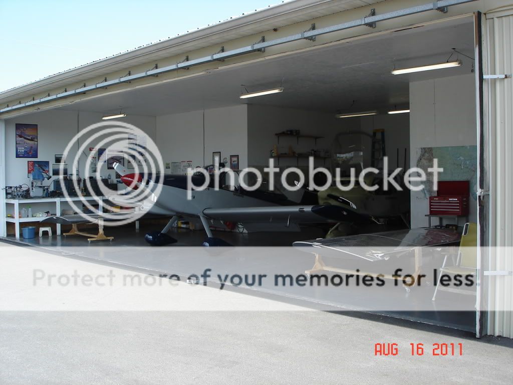

I put mine on and take them off by myself all the time. On the outboard end of each wing is a cradle on wheels that holds the wing horizontal to the floor about 2 ft high; it is essentially a strip of carpet between two vertical 2x4s connected together. On the inboard end is a holder made from 2x4s with a wheel on the bottom; this holder slips over the spar and is held in place with a large C clamp. This arrangement allows me to store the wings low in my T hanger and allows me to park the RV-12 fuselage in the rear of the hanger and my RV-8 in the middle. It is very easy to pull the RV-8 outside, move the RV-12 fuselage to the middle and maneuver the wings to each side for installation; takes about 5 minutes.

Thanks, Gagarin737. I appreciate your help. Here are all of Paul's photos.
[IMG]http://i397.photobucket.com/albums/pp55/mschrimmer/RV-12%20Wing%20Caddy/DSC00746.jpg
For those not yet convinced, today I took my wings out of the wing rack, put them on the "installation rollers" and installed them all by myself. When done with the drilling exercise I pulled them off, put them back on the wing rack, and back inside. The system works quite well as Paul had indicated, I even had a breeze to contend with, no problem. My KitLog will have photos as soon as I upload them.
Don, I had a look at your kitlog pictures. This confirmed two things, ...firstly that the wings can be taken on and off by one person, ....and secondly the build order can be changed for those guys that have limited workshop space like myself. Thanks Don and Paul for your pics.:)

Looks great with the wings and tail off !
With the engine mounted, and using brakes to steer, you have a nice little car !
Now if only the tail was as easy to attach as the wings..
Paul's Design...
Thanks Paul. Another happy customer.:D Your design worked as advertised.
