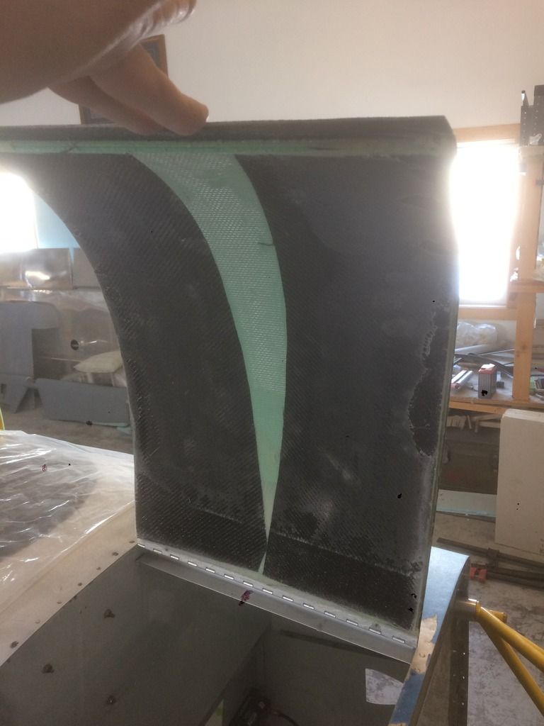

It's a good start. The idea is to have 1/4 turn fasteners on the lower corners instead of the key lock and monkey motion.

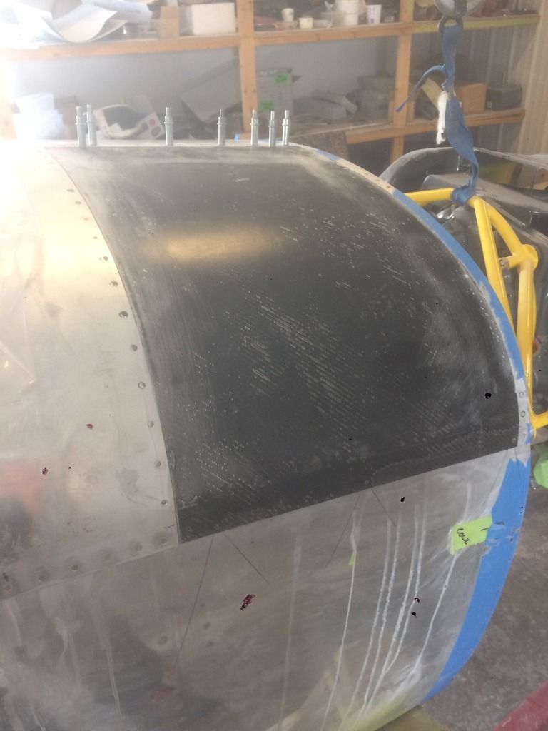

...how to isolate the carbon fiber from the aluminum.
....And vacuum molding only works if you have a proper mold that will not deflect, inside curves require a very very strong mold!! ....

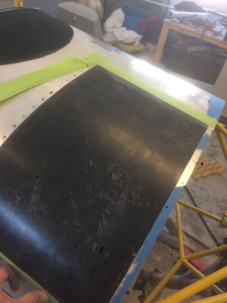

Did the bonding of the foam reinforcing yesterday. And it turned out really nice. The curve of the door needed to be slightly modified as my quick mold was slightly relaxed. But today the door fits really nice! I need to clean up some edges.
And let me add, there is fiberglass on the surface so the carbon won't corrode the aluminum that has been primed, painted, and clear coated.
This particular door along with airplane will be wrapped
In conclusion: this is the "perfect" and proper size part to make a vacuum mold from. Any takers?

The usual approach is a ply of ordinary fiberglass to isolate the carbon. Alternate approach is two coats of epoxy primer and two coats of paint, then hope it doesn't wear though.
If aluminum rivets are used, they too must be isolated from the carbon somehow. Minimum is to wet-set in a moisture proof sealant. Proseal might do.
Good luck finding a titanium lock assembly.
This is not a great application for carbon.
This has me concerned for all the places in the RV-10 doors where screw holes are drilled through the carbon-fiber-reinforced portions of the doors for securing door pin blocks, Vans and PlaneAround rack and pinion units, etc. Seems like the cad plating isn't going to fare well in those locations. Do these fasteners need to be inserted wet with neat epoxy or receive some other treatment to prevent galvanic issues down the road, under the paint?

For you composite experts. Standard use of carbon cloth on our planes it to have it impregnated with epoxy resin. Assuming that there is no raw carbon to aluminum contact because of the resin, does this eliminate the corrosion problem?
