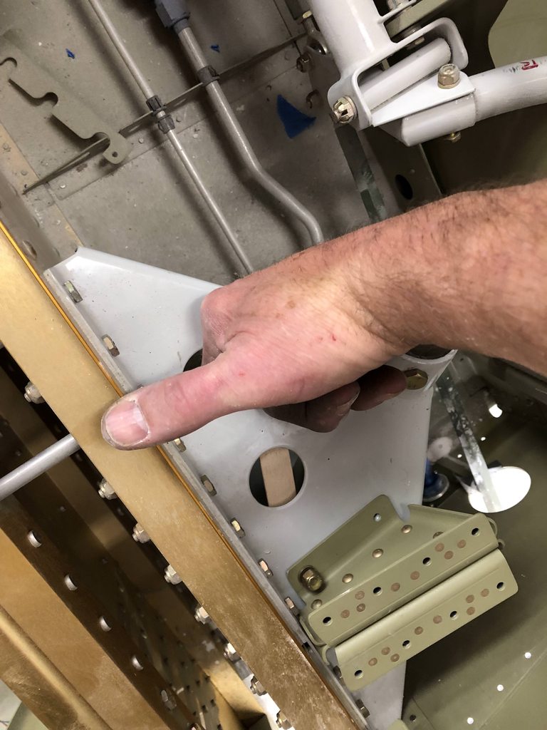

Figured it was just AN3's but wanted to be sure. Actually got the bolts and nuts on this morning, however tightening them is going to be a different beast all together. Might have to recruit my kids with their small hands.

Justin, that?s why I installed with nylocs up. I was able to get the tips of my fingers to install the bolt up. I was going through your awesome build site. Are you going with the std vans cowl?

Yup this is with the nylocs up! I can't get the wrench underneath to hold the AN3. I've already recruited a friend to come by and with her small hands we should be able to get it done.

They are some of the hardest bolts to get into place and tighten. I found it was best to put all each bolt in and only hand tighten the nut, then after all 4 are in place tighten them down for the final installation.

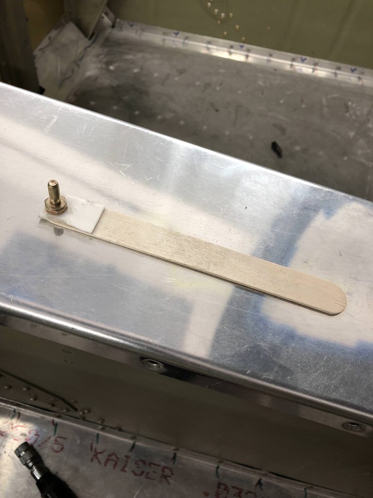

Some of these are beyond the reach of even the slenderest fingertips, and groping with pliers is an exercise in frustration (tried that first). So - double-sticky tape on a tongue depressor is your friend when it comes to getting some of these in.
Leaving these loose till they're all in is a great tip, too. That allows you to cant the assembly to one side to lock the bolts in position one by one as you fit the washers and nuts on each without dropping it back through the hole.

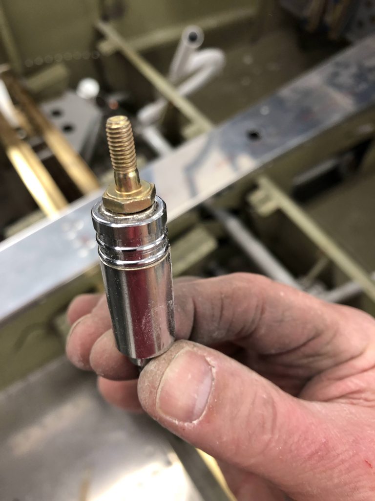

For the holes near the forward edge of the gear tower, I found a magnet was helpful for extending my reach.
The hardest part of this task by far is tightening the bolts. It requires stubby wrenches, box ends ground down in thickness, and holding yourself in positions that are increasingly painful after more than a few moments (at my age, at least). I managed to get a socket wrench and a box end wrench both wedged into tight crevices and stuck onto the bolt heads so tightly it took a hammer to get them unstuck after the fasteners were snugged up. A trip to the grinder for more tool-thinning prevented a repeat of this snafu.
Budget about three hours for this handful of eight bolts. If it takes you less, you have my enduring respect - and you likely have some specialty tools I wish I'd known I was going to need today.
