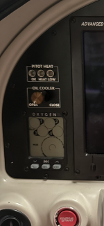

I want to make a panel upgrade and need the panel space so I need to relocate it. Has anyone located the control head in the over head console or side panel? any reason it wouldn't work in the over head?

I mounted mine at the bottom center, it seems to be a popular location:

For any mounting location, the main two concerns are clearance behind it for both the control head and the connector shell, and the fact that there's an air pressure port behind it to detect cabin altitude (so you don't want it so enclosed that it'll delay detecting altitude too much).

Great point, thanks.
