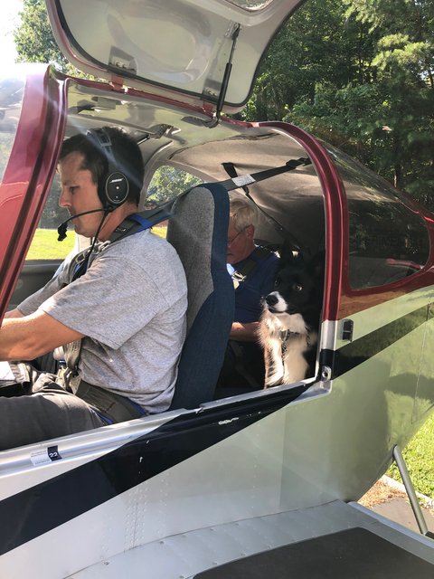

I found one photo. Note the rigid foam filler in the door hinge pockets. This is glued in to provide a flat, continuous surface for the seal.
The seal itself is cheap so you can experiment with different seal height to get the best result.
Carl
Interesting that both of you have a much larger lip left on the cabin cover than the plans show. The scribe line is further down the side of the lip.
Yep - as there was no need to cut it down further I left is as is. If nothing else I figured a little more of this lip would add some strength.
The bottom of the door opening was filled in with rigid foam then fiberglass to make sliding in and out easier.
