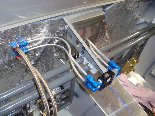

I’m trying to wrap my brain around setting up the Matco PVDV parking brake valve. I’ve looked at the drawings they provide and have the valve mounted on the air ward bracket. Does anyone have a photo of their installation? Id hate to have to crawl in under the panel and rejig things after I’m closed up. I would like to get it right first time.
Here’s a couple photos of my install. I’m beginning to think I’ll need to flip the bracket and use a longer Bowden cable and come from the other way. I’ve hit analysis paralysis
Any advice appreciated.

Looks like you need another 27.5 degrees to close (open) the valve. Cable full travel should be around 1.5 inches.
Agreed. That's how I installed mine but I looked and no pics, sorry.
The lever should travel 45 degrees with the midpoint being straight up and down. (Perpendicular to the valve body)
I had to drill another hole in the arm (closer in) to get that much throw - without the cable coming apart at the actuator side.
Me too
I also had to do a little work to make the arm move the full range.
I drilled a new hole closer in and made a custom mount for the micro switch to let the panel have a alarm when the brake is not off.

Here’s how my friends is setup.
The way yours is at the moment is “pull brakes off” you need to be well clear of the transition zone to ensure brakes are fully off or on. I had to adjust this particular aircraft after it landed with a locked brake because the off position was still in the transition zone originally.
Photos show after adjusting

It would appear you do not have enough arm rotation with that setup. Drill a new hole in the arm closer to the pivot point. This will give more rotation per linear travel amount.
So here is my slightly revised set up. What you can’t see is that when you remove the lever there is a dot stamped to show orientation. If you rotate the shaft 180 degrees the open becomes closed and so on. I now have pull to activate brake and push to release brakes. The lever does not have to travel 180 degrees just be within the arc of activation as shown on the Matco drawings.

What I do (updated after I went back to look at the photos). Please ignore the firewall insulation from 11 years ago. I'm now a loyal follower of Dan Horton's school of insulating only on the engine side of the firewall.
The valve actuator arm is easy to reach from the pilot seat. No control cable used.

This is as it should be. That is the standard, pull to engage, push to release.
