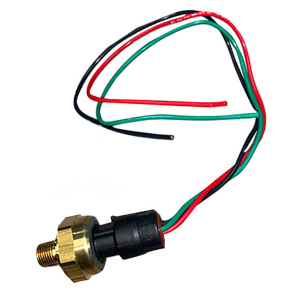

Your G3X system supports many different manifold pressure sensors, produced by various manufacturers... which one do you have installed?
  • 494-30004-01 Manifold Pressure, 30 PSIA, 1/8-27 NPT
It's the Garmin labelled P4055 sensor. The original came in the 4 cylinder Garmin EIS bundle. The 2nd was an aircraft spruce replacement based on the part number above that's advertised as a Garmin part. The one I buy next might not be a Garmin part though if there's a better option out there.
I haven't heard of the Kavlico P4055 manifold pressure sensors having too many problems; I have one in my airplane. According to Table 21-1 in the current G3X installation manual (revision AU) there are other ones you could try, such as this.
