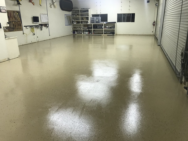

Carlos, that interior is top tier. I love it.
Thank you Sir. That floor coating is Rust-Oleum epoxy garage floor paint straight from the Lowes aviation aisle ;). Most people that complain it doesn't work and peels up are the ones that didn't prep the concrete right. Don't use the liquid etching, it's pretty much worthless; spend the time to mechanically etch the concrete. 5 years on that flooring and no peel up yet. Rent a floor sander from your local equipment renter. To get to the edges of the concrete there's a concrete floor grinder blade that'll attach to your electric angle grinder. No easy way to do it, get some gel knee pads. Vacuum ALL of the dust up first then rinse ALL the dust off a couple of times. We used a pressure washer. Let it dry at least 5 days, maybe longer and then you can start painting the floor. The squares you see in the picture are 10 ft x 10 ft so one Rust-Oleum kit will do one and a half squares. I think I used 6 kits total for my 50x50 hangar.

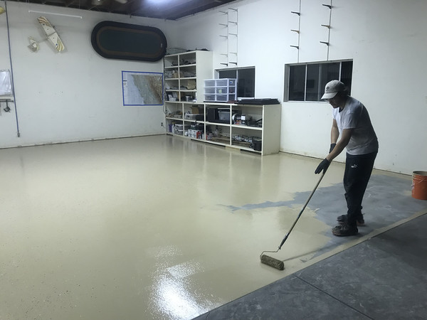

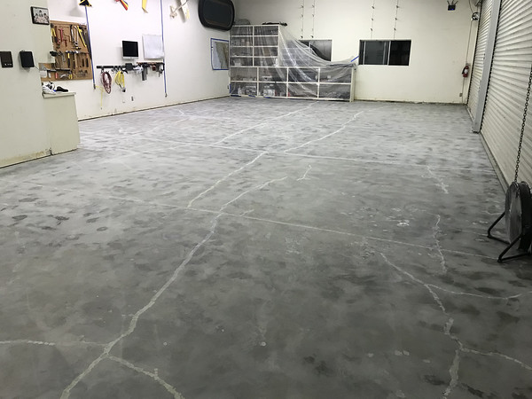

I did the same as Karl. 1. Used an angle grinder with a diamond wheel to rough up the existing (pretty severe) cracks, 2. Filled them with Rustoleum Concrete Patch&Repair, 3. Mechanically etched the entire surface with a walk-behind diamond grinder rented from Home Depot, 4. Coated the surface with Rustoleum Epoxyshield Pro (the solvent-based product, had to buy it online), 5. Topped it off with a clear epoxy topcoat with a little silica anti-slip mixed in. Turned out great.
If your existing hangar floor was poured incorrectly (as mine was, without expansion cuts), it will eventually (re-)crack, and there's nothing you can do about it, but otherwise, the epoxy coating is a huge upgrade and totally DIY-able by anyone.
I originally acid-washed the hangar floor and coated it with water-based epoxy floor paint left over from the garage/basement. After painting the plane in there the floor is now overspray-pink. Since I painted a lot of the removable pieces in the basement to avoid bugs and summer heat, its gray epoxy floor is now pink as well. Wife not happy about it at all. Me, well... I figure the more we use these spaces the faster it will wear off and become gray again.
