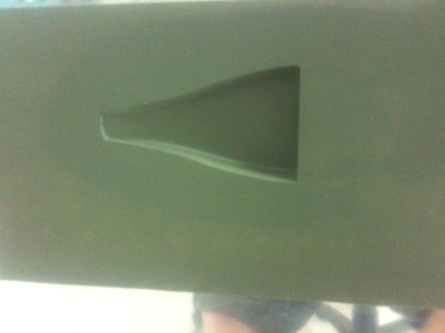

Well, I have just made the most upsetting error in my build to date. I was in the process of installing NACA vents in my tailcone when I kept thinking to myself that something just doesn't look right.
I finished cutting out the vent template and deburred. After looking at it for a few minutes, it hit me like a ton of bricks. I cut the entire vent perimeter instead of just the leading 1/2. I am now the proud owner of a huge idiot mark on the side of my plane. The "easy" fix is to cut a piece of aluminum and rivet it on the surface of my skin and feather in. The thought of this makes me cringe.
My next thought is to try to build something up out of fiberglass to keep my skin surface flush while covering the trailing 1/2 of the vent. I am not sure how I would support the structure, and future cracking worries me.
The best looking alternative is an entire new side skin for my tail cone. Honestly, the thought of drilling out everything and replacing this makes me want to throw up.
I am hoping someone here might be able to offer an acceptable solution. Having another piece of skin material scabbed on top just seems like wearing a big red letter "A" on my shirt. I am still dumbfounded that I have done this.

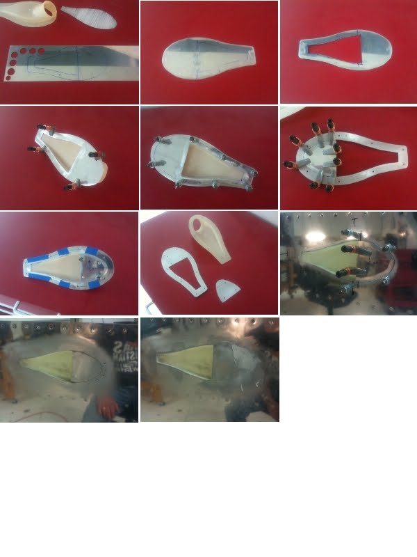

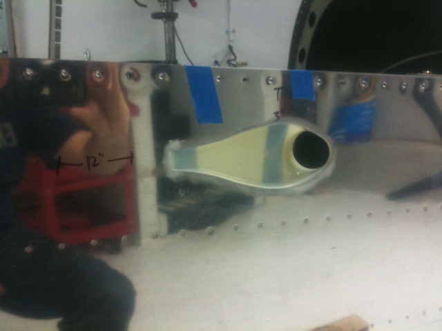

Here is what I came up with......
Thanks again for all of the great ideas! You guys are awesome.
I basically took a little bit of everyones advise along with a few of my own and came up with a fix that I think will look just fine. I still need to sand my micro balloons then prime and sand a few times. After that, I am pretty confident that I will be the only that knows this is a fix. Thanks again!
I've said this many times - the real art of building is knowing how to turn your own mistakes around into a success. Anyone can buy a new part when they mess one up - a true builder can fix most mistakes to established standards. Good job!
