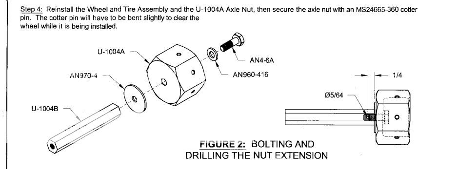

I am at step 46-5 and installing the main landing gear axle nut and cotter pin. I am concerned the cotter pin can rotate in the hole and possible rub against the bearing nearby. I can cut the pin legs shorter, but that seems it would leave them too short. What have others done?
