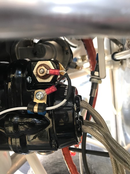

Here's what I think is a pretty nice way to secure the wires on the magneto side. Learned it here on VAF:
