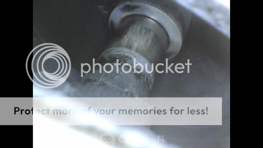

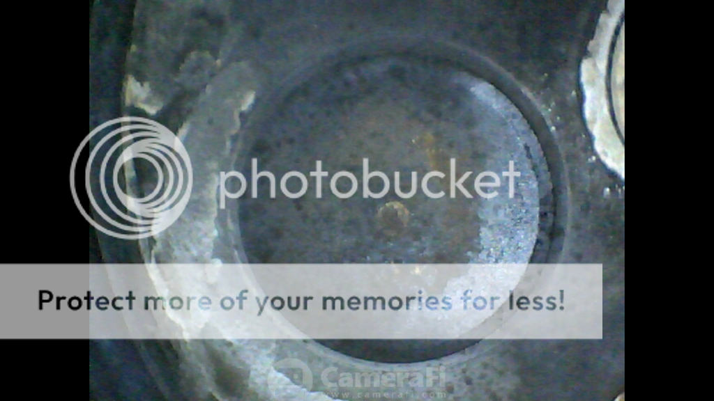

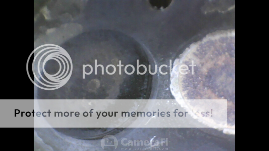

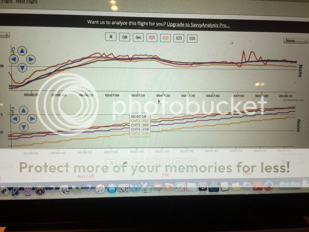

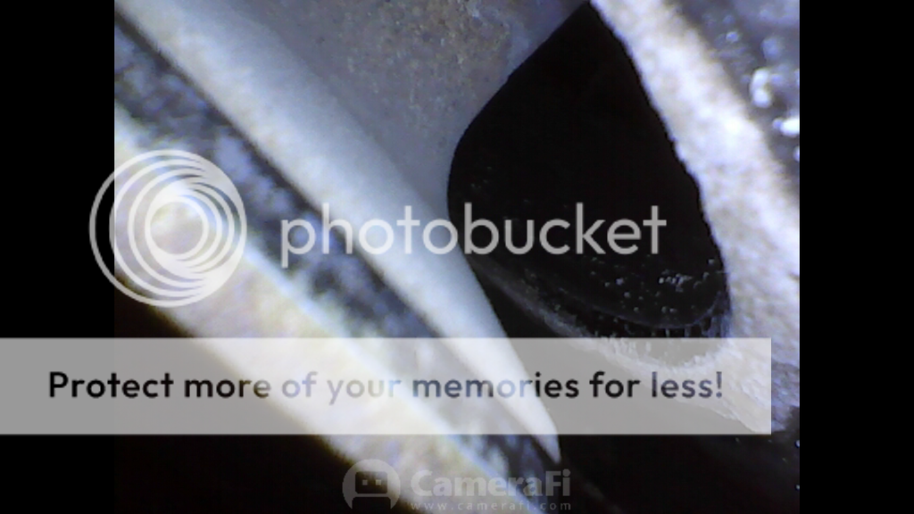

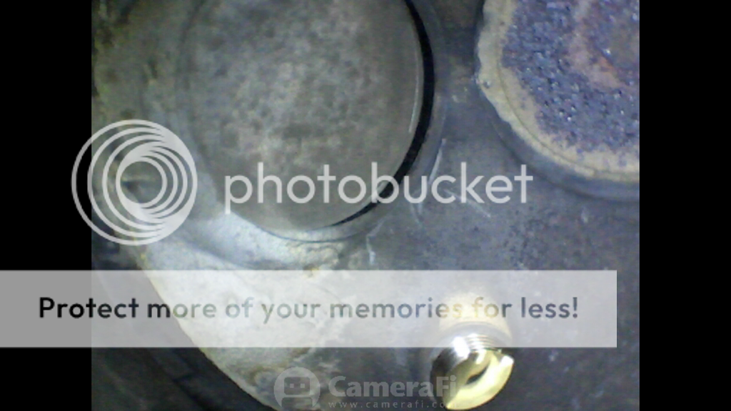

Guys,
I need help a little here, at least some inputs or ideas on my #1 Cylinder
- First one to lean, always before others
- little morning sickness when sitting for a couple weeks,
- GAMI Test, I notice that this cylinder spread is 1G more than others
- Spark plugs have more carbon deposit ( nothing alarming) others are clean, (I Have seen a little oil in cylinder when sitting for a while)
All others cylinders look the same, GAMI spread of 0.3 between others, plugs all greyish / white
I have heard Lifter, cam, perhaps valve sticking, etc. Would like to get your inputs on this one
Lyc. o-360 A1A, 500h SFOH, otherwise stock
