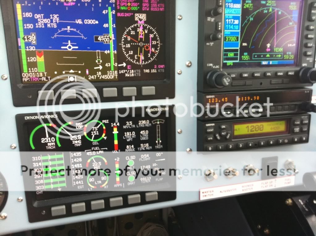

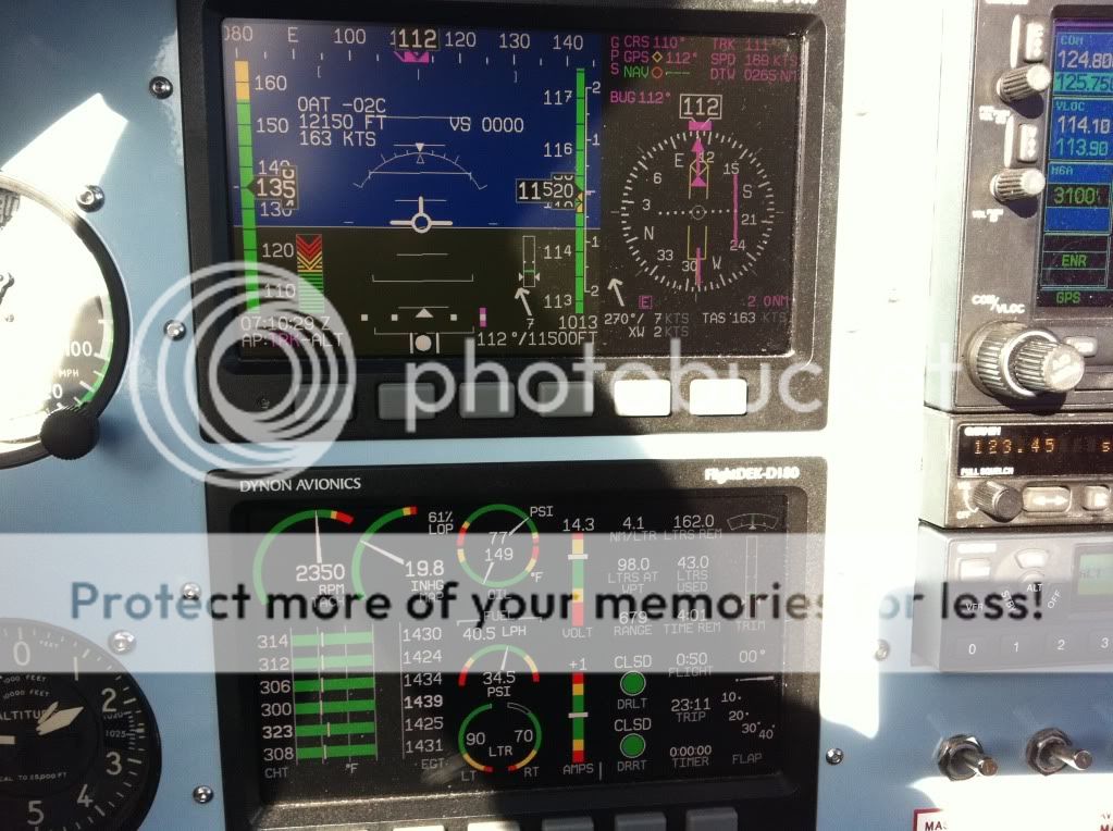

The best way is down low, highest power, if you have cowl flaps(non RV's i.e.210/A36 etc) keep them open and either FULL RICH or 90F LOP.
Most people will run around a bit higher and take a lot longer, so say 80% power and 60-80 LOP.
Which one is cleaner on your engine and has cooler CHT's?
