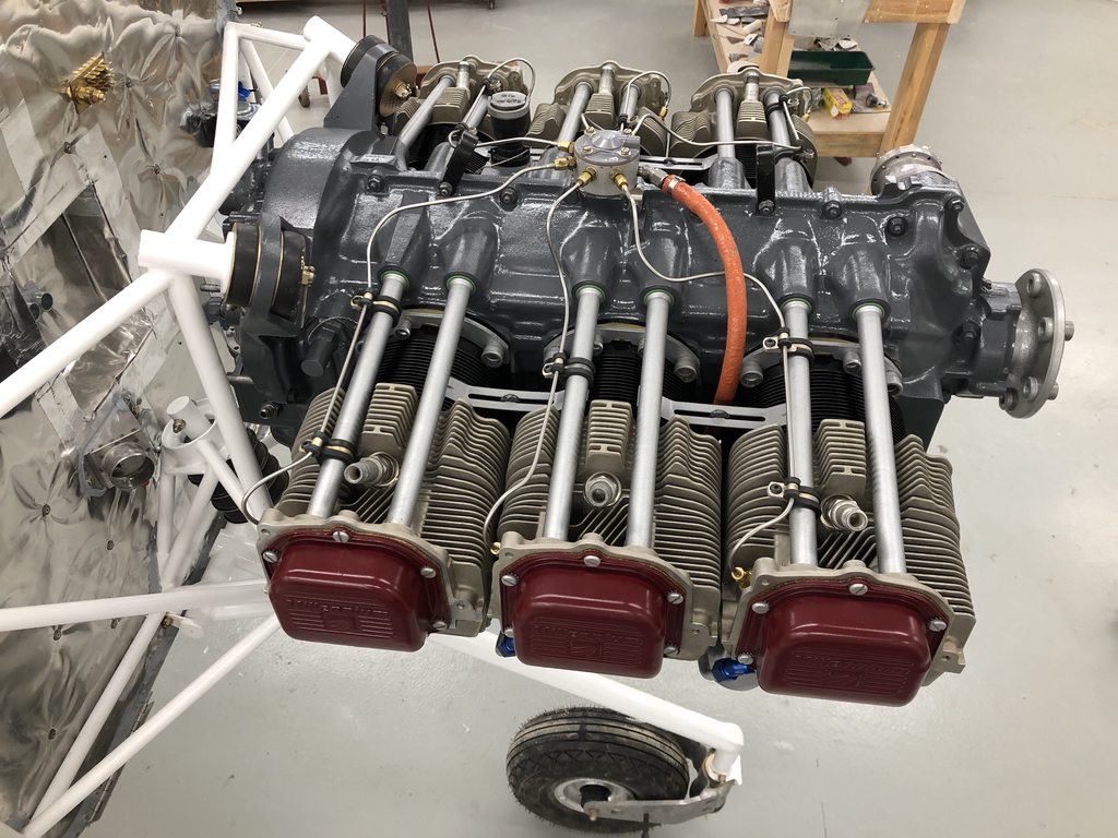

VIP 50804-20 mounts arrived today drop-shipped from the factory. They fit perfectly and bolted up snug.
Had a little problem with the Van's-supplied bolt lengths - needed a little relief filing in the nut castellations in order for the cotter pin to pass through after bottoming out on the spacer and reaching max torque. A thinner washer would have solved the problem but I had none on hand.
Engine mounting went very quickly with an engine hoist and helper - no special tools required, "bullet" bolt guide not used.
I can't attest to the performance of the mounts since I'm still building, but the fit is fine, and the price is right. $114.75 ea at Spruce.
