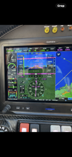

25 squared has a rich history, but no science behind it. Full power, rpm back to 2400/2450 at 500/600’ (after the turn on course) I leave full power unless temps start approaching 400 F. LOP after cruise altitude. Even at low altitudes. Climb @120 IAS.
