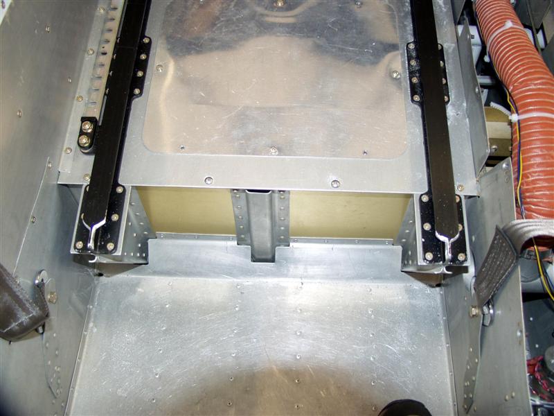

Hey Guys,
I asked the inspector (Vic Syracuse) - who has built a couple of -10's - if he had any tricks for getting the seats out. He said he trimmed off the upper "ears" of the rear of the I rails so that after removing the seat position pin, the seat slides back, then tips up without hitting the flap tunnel covers. I did that today and it works like a charm.

Instead of trimming the rails, consider beveling the front of the plastic strips so that the seat will tip up for removal. (Where the interference occurs.)

Less intrusive...works great too. I just 45ved the nylon parts and it tips up and comes out fine.
Tim
All you need to do is remove the UMHW plastic tracks that go around the
aluminum seat rails and cut the fronts back about 3/8". That allows enough
to remove seats without cutting up the aluminum rails and taking the rear foot/flap kick plates out. It takes about 5 minutes per seat. There is no need to cut the rails.

I did exactly that. Works great. Much easier and cleaner than shaving the rails IMO.
The other half of the seat mod is to attach nutplates on the bottom of the plate where the rear slide stop attaches. A little more work initially, but well worth it. To remove the seats post mod, instead of having to remove the four bolts of the T latch (which face the sidewall), you simply remove the two bolts of the rear stop that are upright and easy to access with a socket extension. With these two mods, removing the seats is a two minute job each. Remove the two rear stop bolts, pull the T handle, and the seat slides right out clean. Both mods are no brainers and should be incorporated into the Van's manual. They have both been discussed on the forums extensively in the past with details and pictures.

It is the only one I can really recommend because it maintains the full integrity of the seat attachment to the track.
Trimming the aft portion off of the track has no influence because the position of the seat in flight (even for someone with very long legs) puts it no where near the aft end of the track.
