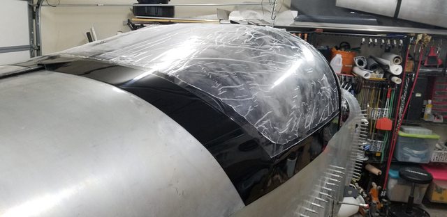

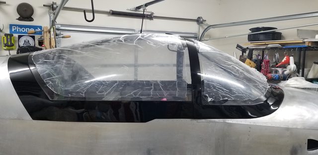

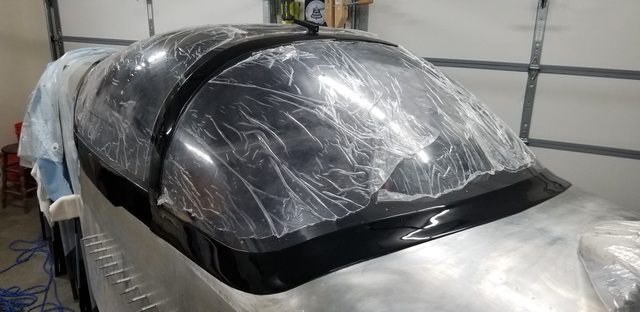

On my 7A I took a different approach. Someday, the windshield may need to be replaced so I made the one piece trim removable. It's bonded with Sika. As such, the inside surface was primed with Sika primer. So it's black. No dye needed. I layed up 5 layers of 8 harness. Popped it off. Finished it. Painted it. Bonded it.
Here's how it looks.
The way Larry did his layup with a removable fairing is spectacular.
Thank you. A fellow builder came by the other day. He tapped it with a fingernail and asked if it was plastic. I said no. Fiberglass and paint. He said, you can lay down paint like that?
I said, oh no. I can Cut&Buff thanks to Dan's postings! :D
Here's the side and rear view.
