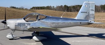

I have an RV-12 with Skyview D1000 and Garmin SL40 comm radio. I want to add a second comm radio (considering the PS Engineering PAR200B audio panel with the Trig TY91L remote mounted radio). The existing comm antenna is as per KAI 42M-07: mounted underneath, offset from centerline.
Any suggestions for locating a second comm antenna?
Has anyone been successful (lack of interference) mounting it underneath, offset to the other side?
I added my second comm antenna on top. Based on the antenna drag number I ended up with a doubler under the skin along with two J-channels between the frames to stiffen the thin skin. Adding another COAX from the front panel was another problem to be solved due to the limited space in the tunnel snap bushings. Issue with the bottom is I already have IFF, ADS-B and COMM antennas there, plus switching from bottom to top helps in some situations where I have poor comms.

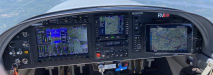

I am running an Avidyne IFD540 as COMM/NAV 1 and a Garmin GTR-200 as COMM 2. I built a custom one-piece panel with redesigned radio support brackets. I ended up adding another set of 3/4" snap bushings to accommodate the added COAX (NAV/ILS antenna, GA35 GPS, and COMM 1) in the tunnel. I use the Garmin mainly for AWOS/ASOS with voice comms on the IFD540 (better comm quality).
