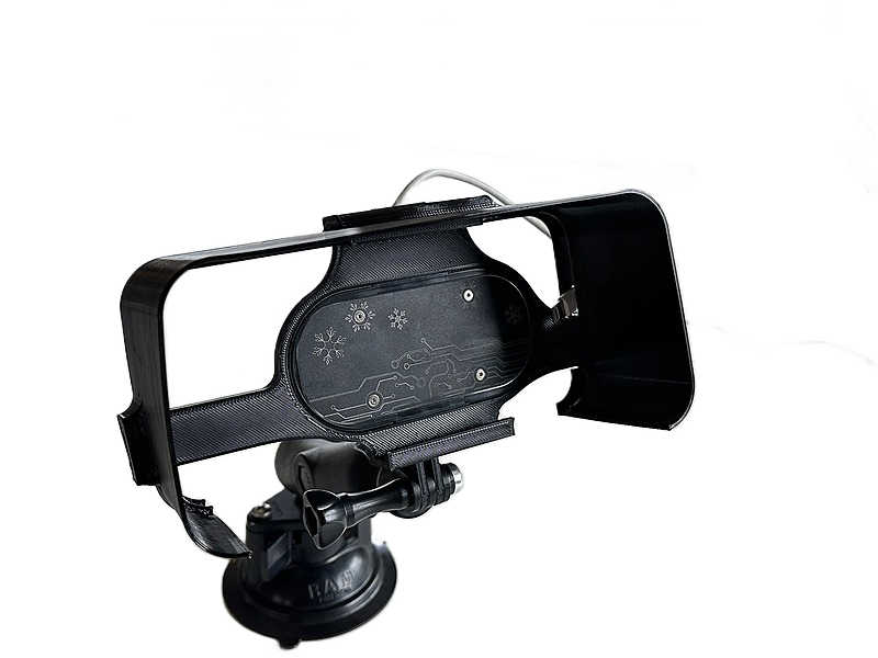

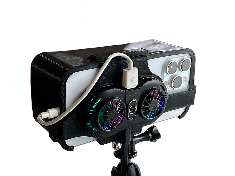

I built an iphone mount with a peltier cooler built in that keeps the phone from overheating. I use it mostly in gliders but works well for keeping the phone at full brightness in the RV bubble canopy as well.
Do you by chance have STLs for this? Funny enough, I just picked up a Peltier cooler that snaps onto the back of my phone via MagSafe, and I was able to have my phone hang out in full sun last weekend and didn't experience any screen dimming due to thermal throttling.
