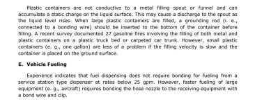

Maybe this is the reason..... And it doesn't look like the volume of flow through our 3/8 teflon lines are an issue.
I would like to see proof of 32 oz of fuel (max) passing through a teflon fuel hose over a period of one minute and
creating any static charge. The carbon doubles the cost of the hose..... Is it really needed for our fuel flow?

Should wait for Tom to weight in but I’ll run my mouth anyway. Static discharge in a fuel line (or any other process fluid) was never a real safety hazard. Got to additionally have oxidizer to make things exciting. I thought the conductivity of the liner eliminated the spark erosion associated with the discharge -> helped get rid of the calendar life limit on the hoses. If TSFs Tom doesn’t set me straight here soon, I’ll email him and ask for a response here.

Aren't our fuel lines grounded at both ends? Where is the potential static charge being built up?

true, but as fuel flows the static electricity can attempt to take a shortcut and seek a ground by finding the stainless braid. The liner is thin, so it doesnt take much. The carbon provides the conductive path to the hose ends, and not the outer braid.
