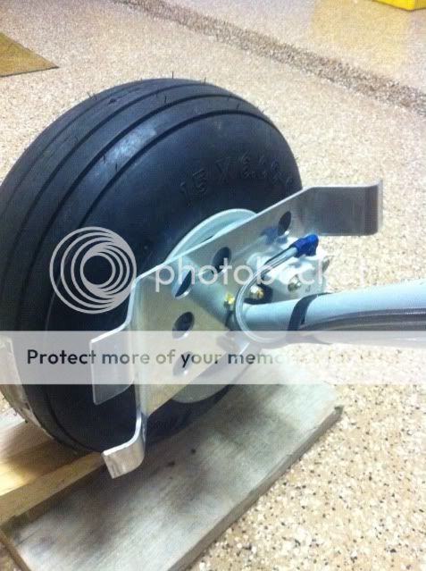

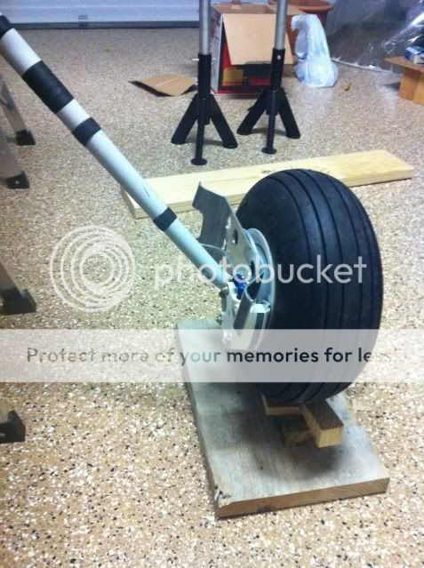

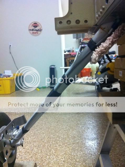

Here you go....
Here are the photo's of 31.5". It works like a champ.
Front View:
Rear View:
Routing:
