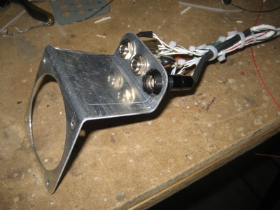

I wired for both at all four headset locations. It’s worked out really well for the last ten years. You never know when somebody wants to use their headset.

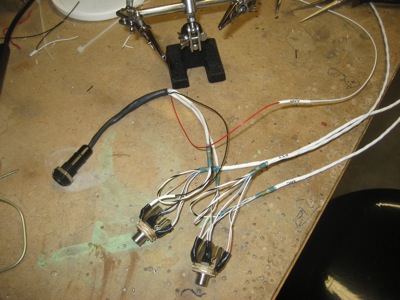

Is there a standard way to wire for both LEMO and dual plug? Are they simply tied together at the station, or do you need separate runs for LEMO and dual all the way back to the audio panel?
I simply wired the phone and mic leads in parallel on each headset connection location.

I put in both (bought the "raw" connectors off Digikey and soldered them myself, saving a little $$$), and bought some LEMO headsets when I ran across a good deal. I liked the idea of ship's power to run the ANR, especially having killed more than a couple 9V batteries in Dad's headsets forgetting to turn off the ANR after a flight :eek:

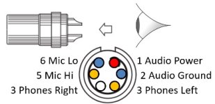

Do you happen to have the Digikey part#/SKU - I looked at the pre-wired Bose versions and the cost made me gulp but happy to wire up my own. Want to be sure I get the right sockets.
Robert
This one?
So it looks like it is powered from 14V aircraft, but yet my old style uses 2x AA. So i have to buy a LEMO headset???

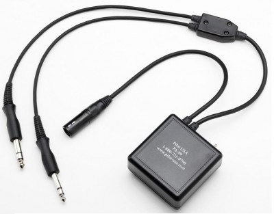

Been using this ^^^^^ with my Bose A20 when I fly in other GA certificated aircraft. (can be purchased for a lot less if you shop around)
Got rid of my Lightspeed LEMO headset because it needed to use a battery pack like this VVVVV to be used in other GA certificated aircraft.
https://www.aircraftspruce.com/catalog/pspages/pilotUSA32.php
There's also this kind. A little clunkier than what mburch posted, but it has a space for a 9V battery to power the ANR. I have one and have tested it on the ground, at least.
