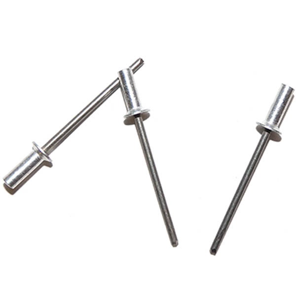

Looking for the person who makes a special rivet for a leaking fuel tank I’ve searched and it looks like it’s an HFS signature. But appreciate any contact info. Thanks.

Over twenty years ago I used this pop rivet to fix a weepy tank rivet:
This requires carefully drilling out the offending rivet, popping off the head then drilling out the hole to #30. Use a deburring tool to do the very slight counter sink on the hole to best seat this larger rivet. Add pro-seal into the hole and pro-seal on the rivet. Set the rivet and clean off the excess pro-seal.
This fix never leaked again.

Just for clarity - this is the wrong rivet to use because of its grip length - .125” - .187”. The unmodified rivet you would use is a Pop AK41H or -42H, depending on its placement. Not saying this one won’t work, but it is not recommended by the manufacturer for the thickness of the joint involved here.
I make a modification to the above two P/N’s that reduces the head to the correct size & shape (100* head angle vs 120* for pulled rivets) that I offer for leaking fuel tank rivet repair.
I also modify standard (open end Avex) rivets for those hard to reach (read “buck”) rivets that might need replacement due to “smoking” or …
Shown below is a comparison (L to R) of a standard head (AN) rivet, my reduced head, correct included angle and a standard AK41(2)-H.
YMMV - But this works …
