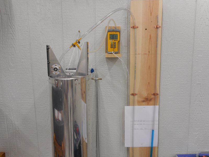

Another Manometer
Here's my leak test at 27" of water.
The tanks bulge out noticeably with roughly 1 psi in them.
The manometer is definitely sensitive to temperature. It appeared to be leaking after pressurizing it and then I realized the soapy water in my spray bottle was cold and the combination of cold water and evaporation probably cooled the tank by 15-20 degrees. No bubbles. As soon as it warmed back up, the pressure increased and the water level returned to the original mark.
Going to let it set for a few days, keep the shop roughly the same temp and monitor atmospheric pressure for up and down trends.
So far no leaks as far as I can tell. I plan to put avgas in them as a final proof as well.

I don't believe the failure was caused by mixing, or by a bad batch, because the sealant that was on the Van's supplied fuel pickup tubes failed also. That was a different batch mixed by a different person.
It is not uncommon for tank sealant to revert to goo and there are reports on VAF of it occurring, typically in the vicinity of a leak e.g. on the rear baffle.
