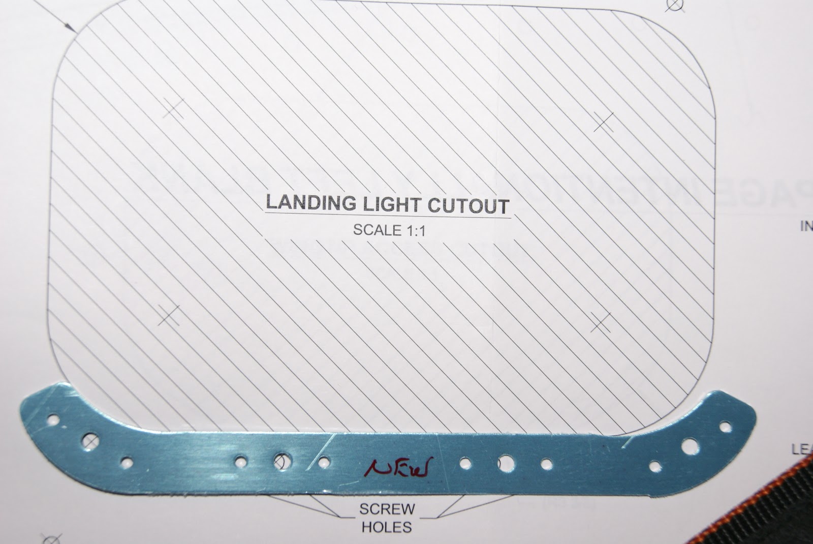

Check the scale of the template used
David-
I would have had a similar issue I believe ? About this time last year prior to marking, cutting and drilling holes, I noticed when placing the backing strips over the drilling template, did not align correctly ... in fact, it was way off as you can clearly see in the following photo.
The bottom line, the paper template Van?s supplied in the plans was printed to the wrong scale. Van?s was contacted and new drawings were sent to me ? Also as a side note, I pressed Van?s about the dimensions they stated in section 3-04 for the size of a template sheet which still did not match dimensions stated in 3-04 ? however, the holes aligned perfectly on the new drawings but the overall dimensions of the drawing at the borders did not match what was called for in section 3-04 of the plans. Was told they would look into it.
By this time it was around Sun-N-Fun so a week or so after the show I wanted feedback and closure about the dimensions called out in section 3-04 so called Van's again was told they had an error on the plans. The dimensions stated in my plans for the templates were 16? x 10 5/16? at the borders. Van?s told me that that was a misprint and the template page dimensions should be 16? x 10 9/16? at the borders. I posted the new information here at that time.
If the template WAS off ? then would suggest you make new backing strips to match the holes you already drilled. This should help relax the metal some.

Check the shape of the lens
David-
Another thought ? after posting my previous post, I remembered there was another area that presented a problem during the light instillation ? and that was the shape of the lens itself.
Apparently earlier versions of the light's lens were made from thin material because the initial lens shipped with the lighting kit was thin and somewhat flexible. However, the lens that came with the second wing light I ordered was at least twice as thick (think it is also used on the RV-10) ... anyway it is a whole lot stiffer. The thin lens conformed to the curvature of the leading edge like a glove with very little pressure applied. However, the thicker lens was not even close and could not be flexed by hand to fit ? either the bottom would sit flush with the skin or the top but not both. If memory serves me correctly, it was over bent from Van's.
I had to do quite a few cycles of heating the lens with a heat gun, relaxing the curve a little and letting it cool. Also used the leading edge of the wing to help form the lens as it cooled. Eventually, both the top and bottom of the lens was made to fit fairly snug to the curve of the leading edge. It was not as perfect of a fit as the thinner lens, but acceptable.
So assuming the holes in your lens backing strap matches the template perfectly (and drilled skin holes) and the wing skin has no bulges without the lens screwed in place, your bulge issue may very well be that the lens is NOT conforming to the curvature of the leading edge and not sitting flush on the wing skin BOTH above and below the light cutout ... as was my thicker lens before tweaking.
Hope this info and the good tips you received from others help you resolve the issue. Good luck and happy building,
David-

Follow up
thanks all, for your suggestions.
The dimples were too shallow because I didn't use the correct dimple die set. That's been corrected. I've trimmed the lens to the backing strips to minimize its size. The template was accurate with respect to the backing screws. Lastly, I very slightly filed some of the holes in the wing to allow the screws to start normal to the skin surface to reduce some of the pucker.
I'm still not happy at all with the way it's turned out. There's a good 1/4" gap between the leading edge of the lens and the skin. I didn't know about the trick of using heat to make the Lexan pliable enough to reshape to match the wing.
Does anyone else have this much gap? If not, I'll scrap this piece and start over with fresh Lexan and new backing strips.
