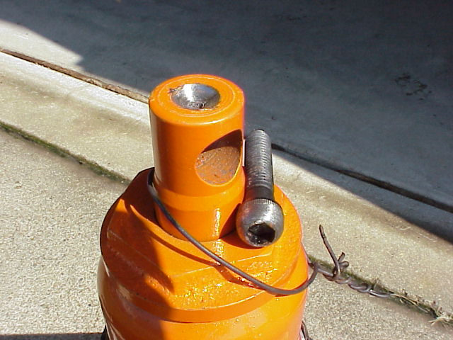

I?m at the point where I need to fit my wheel fairings and was wondering what methods people of used to jack the airplane up. I assumed this was done at the landing tube much like the 182-RG but I haven?t seen anything like this discussed?does anyone have ideas or links to where they may have purchased jack modifications for the RV-10?
I stole this idea from a buddy RV builder KC. The screws are modified from hex head cap screws and screw into the hold downs under the wings. The cylinders come from Harbor Freight for about $40 each. They work on any RV, even a -3. Baling wire screw holder optional.
