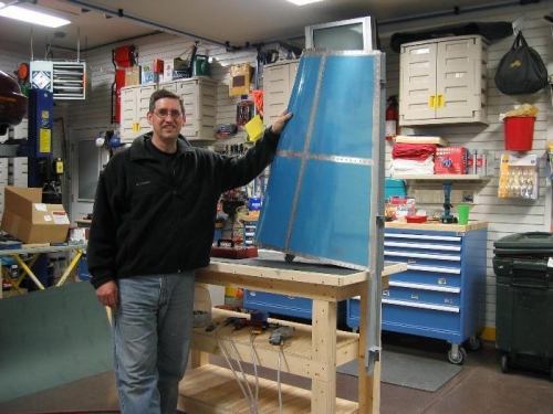

Just finished my V-stab a few days ago...
