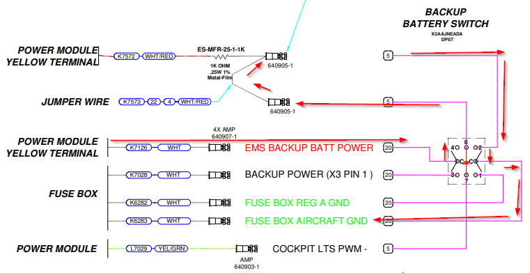

I finally got to the point where all of my wiring is done and I decided to flip the MASTER ON to see what happens
A few things didn't go quite right and I'm just now beginning to double check my work. But the most obvious problem is that I popped the 30A "EMS Backup Battery". Ok something past the breaker is grounded out..
I found that the wire to the LED of the switch was hooked up to the wrong terminal. Not sure how or when it happened, but the wire on 4 should be on 8.
Just posting in case anyone else experiences the same thing.
If your top center terminal is empty, then its wrong.
![powerpic3.png](/proxy.php?image=http%3A%2F%2Fbluehawk.monmouth.edu%2F%7Ercarsey%2Fpowerpic3.png&hash=35d3cbabfb0b00ca0f7a2c54cd218b84)

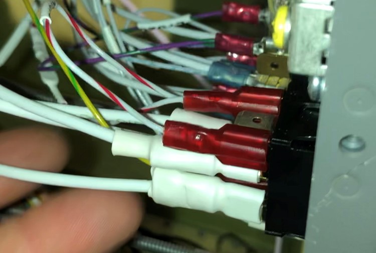

![powerpic4.jpg](/proxy.php?image=http%3A%2F%2Fbluehawk.monmouth.edu%2F%7Ercarsey%2Fpowerpic4.jpg&hash=ae4537a919b70cd6eb1b2a1538a244c0)
