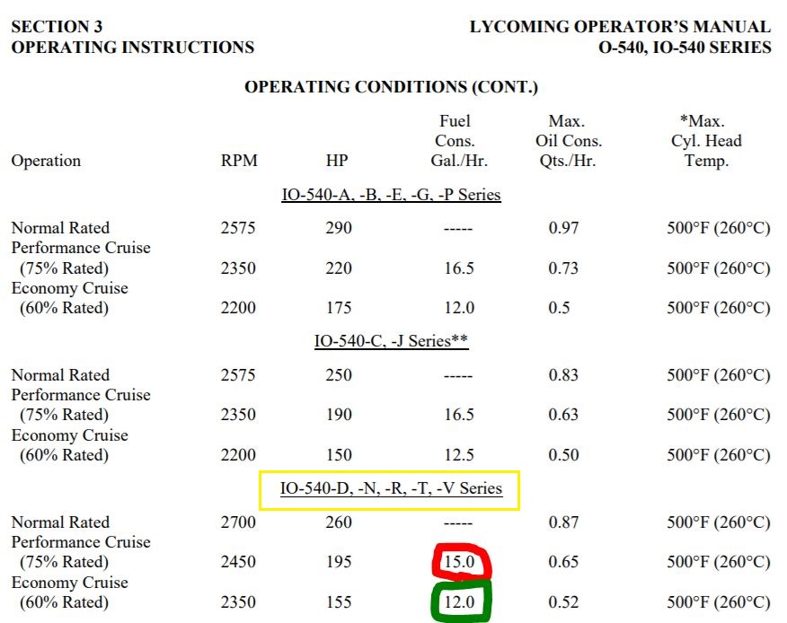

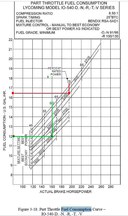

I'm a bit confused with the chart provided in the IO540 ops manual:
-according to this chart fuel consumption at 75% Best Pwr Rating is approx.: 16.5 gph, but the table with Operating Conditions shows 15.0 gph?
-at 60% Econ. Pwr the fuel consumption of 12 gph seems to correspond with the Operating Conditions table.
Do I misinterpret the figures?
EDIT: My green vertical line is a little offset to the right.
![IO540-fuel-consumption.jpg](/proxy.php?image=https%3A%2F%2Fi.ibb.co%2FnmLdn2J%2FIO540-fuel-consumption.jpg&hash=fb002a6e9982804f903e9ebc8ca4babe)
![Capture-Ops-Condition.jpg](/proxy.php?image=https%3A%2F%2Fi.ibb.co%2Fc238hDk%2FCapture-Ops-Condition.jpg&hash=c4ddcfc82d9091dcb0826587b4852afa)
