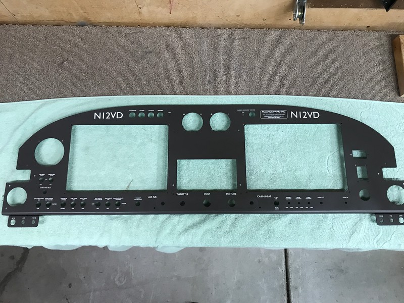

Panel label DIY?
Im bringing this post back because I still can’t find a great solution for switch lables and such.
I have a hand cut panel, so no CAD file.
I can paint it myself but need a good option for lables that look good. I assume no silk screen printer or lazer etch company can work on my 1 off panel. Heard from some about transfer ( rub on ) lables that you can print at home with some special equipment. Anyone know if this works?
Also heard of a company that will make the rub on labels for you but I don’t know how to design the proof to send them.
May find an artist to just paint the letters and I’ll clear coat over the whole thing. Seems too labor intensive in this modern age.
Any inputs? Thought I would save a bunch by cutting my own custom panel. And It came out great but if I have to put lable maker stickers on it- it’s not worth it.
Try Booth Manufacturing in Fort Pierce Florida. 772-465-4441-X258. [email protected]. Talk to Eric.
Excellent work, quick turn and reasonable prices.

Screen Printing - Find Aviation "Friendly" Printer
I found a local printer whose owner was a pilot and wanted to be user "friendly" to the EAB community (now 20+ years ago).
They were willing to work with me to print my call sign on the panel, and then all of the labels onto the lower sub panel - and did a beautiful job.
A couple of caveats: 1. You're paying for screen development for one item only - that can be pricey, depending on how badly you want that quality of finished product. 2. The screen print frame requires a completely flat surface (at least in the area to be printed), so any flanges, or protuberances can't get in the way of the screen.
In my case, the lower sub panel had a mounting flange that interfered with the print frame. So ... what I did was make a flat "overlay", matching the face dimensions of the panel, had that printed, and then installed as an "overlay" when finished. If done right, you can't tell there is an overlay there - I have had people look at the main panel & sub panel for 20 years now, and not one has ever ask about an overlay on the lower panel.

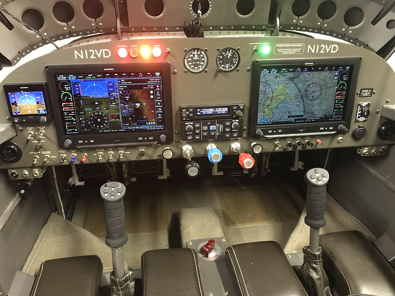

I agree with Carl. Clear Rhino labels on polyurethane. Still perfect 3 years after application. I haven’t seen an RV panel more than two years old that didn’t get modified somehow.

Ditto. I was thinking the same thing. No reason to over think it. Heck, I won an OSH award with a rattle can painted panel and labels printed on a laser printer at home. As far as I know, it is still flying just fine 16yrs later.
The next one isn't much different.
I painted mine with rattle can Rustoleum, wet sanded down to something like 2000 grit, then applied rub-on labels, then went over everything with clear coat.
For the labels I went with https://www.rubontransfers.net. Sent an Adobe Illustrator file and received the labels in the mail. I got three copies printed in case I screwed any of them up. For layout, I tried to do them in rows so that I could apply an entire strip to do multiple switches, guaranteeing they lined up properly on the panel and didn't end up crooked.
