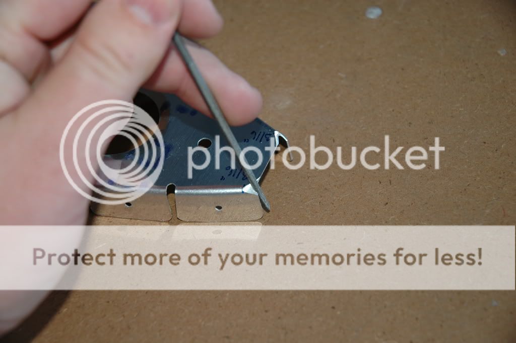

Rick,
Is this similar to what you're doing?
Phil,
I think that's exactly what Rick is referring to. Thats what I did to my nose ribs along with some small metal tooling to get rid of the sharp edge and stop it from diggin into the skins. I think they came out pretty well. Mel is correct on the material removal post but the HS ribs on the -10 are a different animal that Van's doesn't want to address for some reaason.
You can cut the nose back if you want just maintain your edge distance from the front most hole that the skin attaches to. The large hole is in fact a tooling hole and is not used for anything except to put a big cleco in to align the rib left and right while trying to fit the skin to the rib. That's a hint/tip.:D
Scotchbrite wheel
I found that using the Scotchbrite wheel on the grinder worked extremely well for completely rounding off the offensive edges on nose ribs.
Phil, Yup...that's it!
Good pic Phil...that's what you want to do. Take off the 'forward corners' as far back as you need to to provide the necessary relief. To be sure it's best to trial fit each rib after you make the modification, being carful that you don't have to 'jam' them into place.

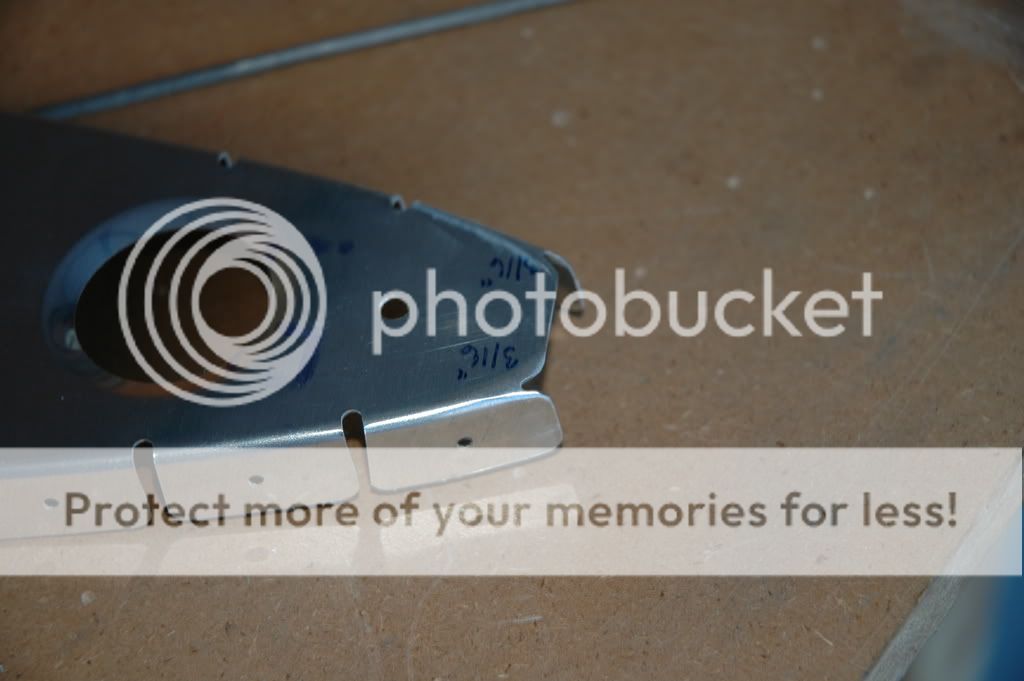

This morning, I got started on the bottom nose rib.

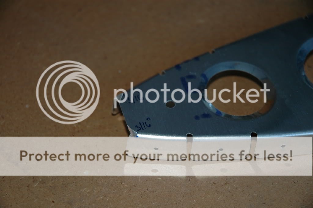

I started off marking 3/16" from the tip of the nose rib.
Then I went to the belt sander and tapered the rib from the tip to the 3/16" line.
Then I used a small round file to clean out the thin material between the flange and web.

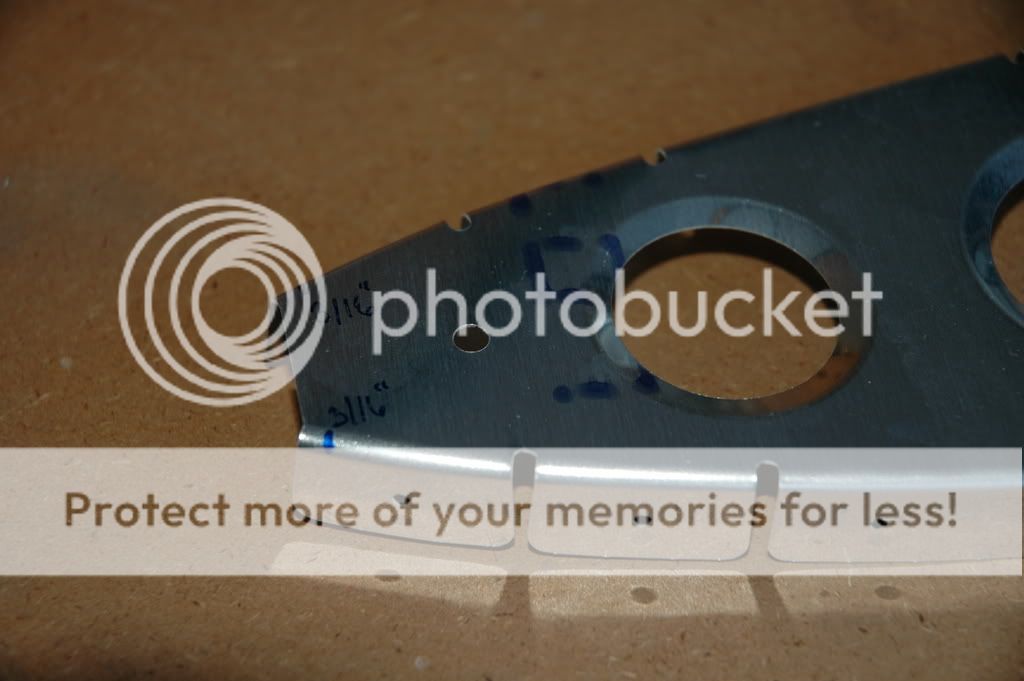

After test fitting, I found I was still getting a very small bump. So I continued to removed material until I didn't have to jam the rib into the hole. (I still feel like I have to press it into position, though. It's not an easy fit. I just didn't feel like I wanted to remove any more material.)

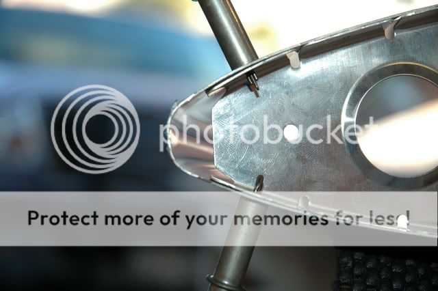

Here is the rib cleco'd into position.
Does it look like I did it correctly? Or did I remove too much?
I went ahead and did the other two nose ribs. The bump is there if you look closely, but you've really got to look hard to see it.
As far as fit, they aren't a breeze to put into position. It still takes quite a bit of effort.
In general, I'm happy with the way it turned out. As Rick mentioned before a half inch seems to be the magic number. All three ribs required a 1/2".

Hey Phil,
Good job...your comments and pics will help the next guy(s) down the line! Nice touch dressing up the notch with your file!
Yup....about a half inch :).
