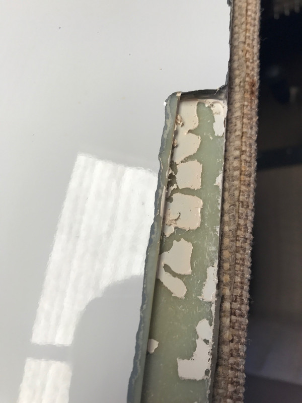

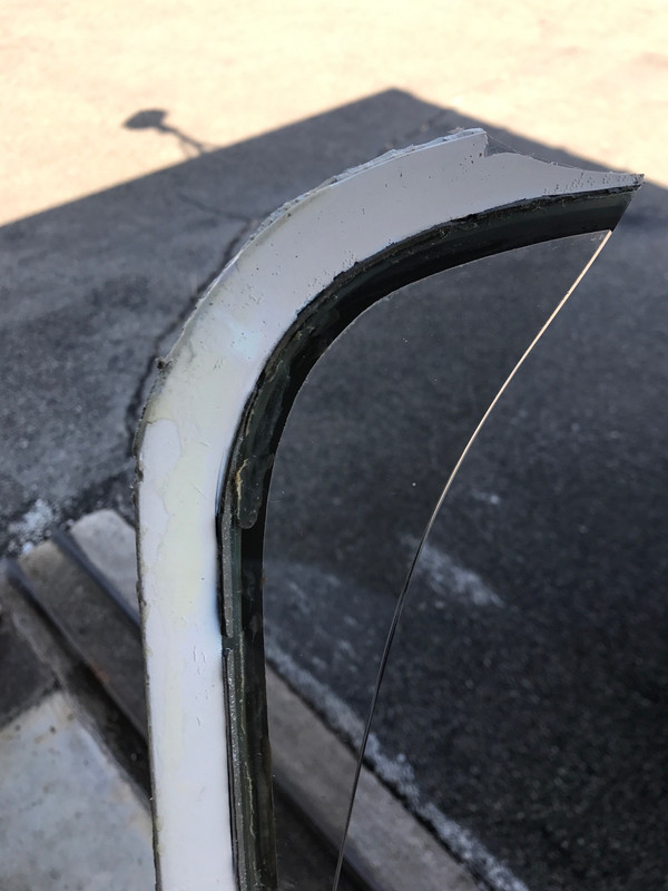

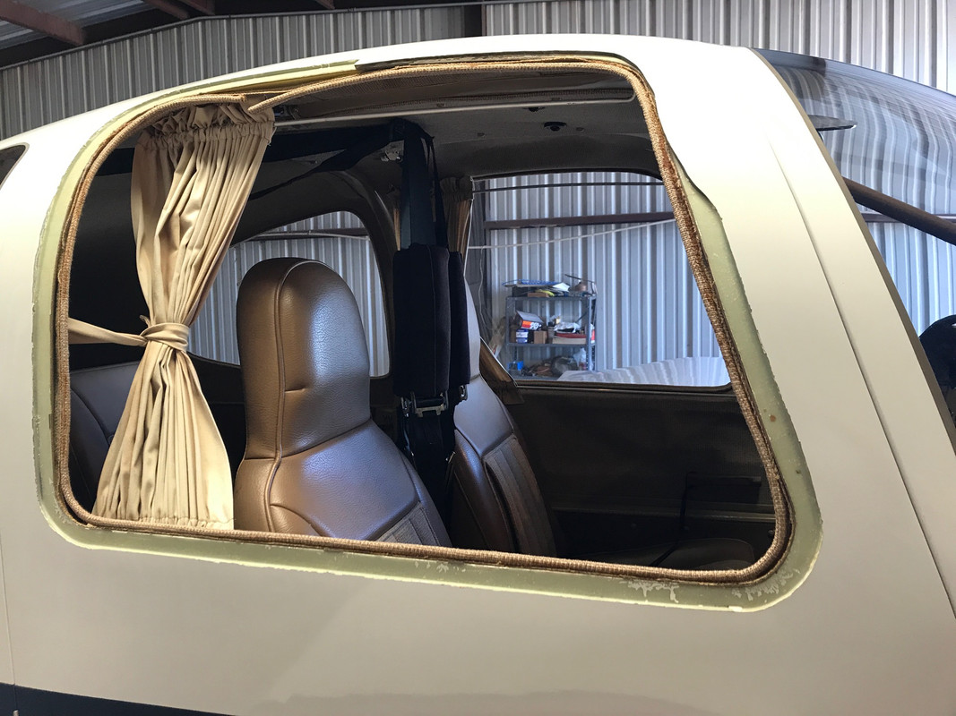

Well,I got my window installed and ended up using the Weldon from Vans. It is just as bad to work with as described. Was going to use Lord,but Aerosport was out of stock and could not give me a definite date when they would have it. I wanted to get flying sooner that that. Used Vans window vs Cee Baileys b/c Vans is .150 and Cee Bailey says their side glass is .125 But the trimming is time consuming for sure! Now I am putting on my flame suit,but I have decided to put c/s #6 screws in the corners of All my windows with nylock nuts on the inside so that I will only lightly snug them. I have a full Flightline interior and the "rope" trim will cover the nuts. Experimented with the remaining parts of the old window as well as the cutoff parts of the new window and it works quite well. Gonna glass over it anyway so I like the belt,suspenders & elastic waistband! Flame if you choose but if you haven't lost a window in flight,turn down the heat just a bit. This is why they call it experimental,right? Just thought I would relay "the rest of the story"
ps;Vans tech support didn't see anything wrong with my plan,thought it sounded feasible.
Your choice on adding the screws, but if you do take steps to mitigate possible crack issues by:
- Use a Unibit to oversize the glass screw holes to something like 3/16?.
- Countersink the holes to accept a #6 tinnerman.
- Glass over the screws and tinnermans as you suggest.
The objective here is to have the tinnerman spread out the screw clamp pressure over the edge of the hole, and the screw does not touch the glass so you avoid creating a hot spot.
This process worked well on RV-8 and 8A canopy glass.
That said - I offer that adding the glass over the outside as I discusses should be more than enough to let you sleep at night. But - your plane so build it like you want.
Carl
My experimenting has definitely been with holes larger than required for a #6,but not as large as 3/16ths. Wasn't planning on tinnermans though. On the scraps I countersunk to where the screw head is slightly below flush to allow for sanding the plexi down for glassing. I wasn't planning to have any tension on the screw at all,just engaged in the nylock and still able to rotate fairly easily. More of a backup safety device. But I listen to all input and welcome it.

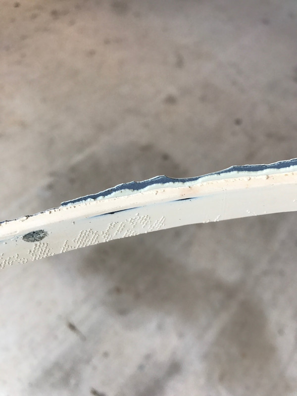

I used sika. Very secure, but you need a plan to deal with the expansion and contraction. The sila bulges when the window expanda and creares a valley when the window contracts. Must changes happen at the two front corner and the rear arc. I wish i had taken the time to clean up the joggle edges and did what Jan did. I have the old green top and the workmanship was horrific. I used a flexible bondo instead. Not bad, but the bulging would be less noticeable with the black accent
One of the reasons it is so secure is that the adhesive flexes and conforms. With a ridgid adhesive loke weldon, the glue joint is taking all of the stress from the expanding plexi. Any weakness ther and it will snap loose like the op saw.

As you noticed, the force on the window in flight is minimal. The stress on the joint is from the difference in expansion rates, in my opinion. I believe that baking on the ramp is the real evil here.
Maybe I said something confusing but no,I don't think the force in flight is minimal,I think there is quite a bit of lifting force on the side windows in flight. As there is on the doors. But I agree with you that heat on the ramp leads to the cracking in the paint from the different expansion of Plexiglass to fiberglass.

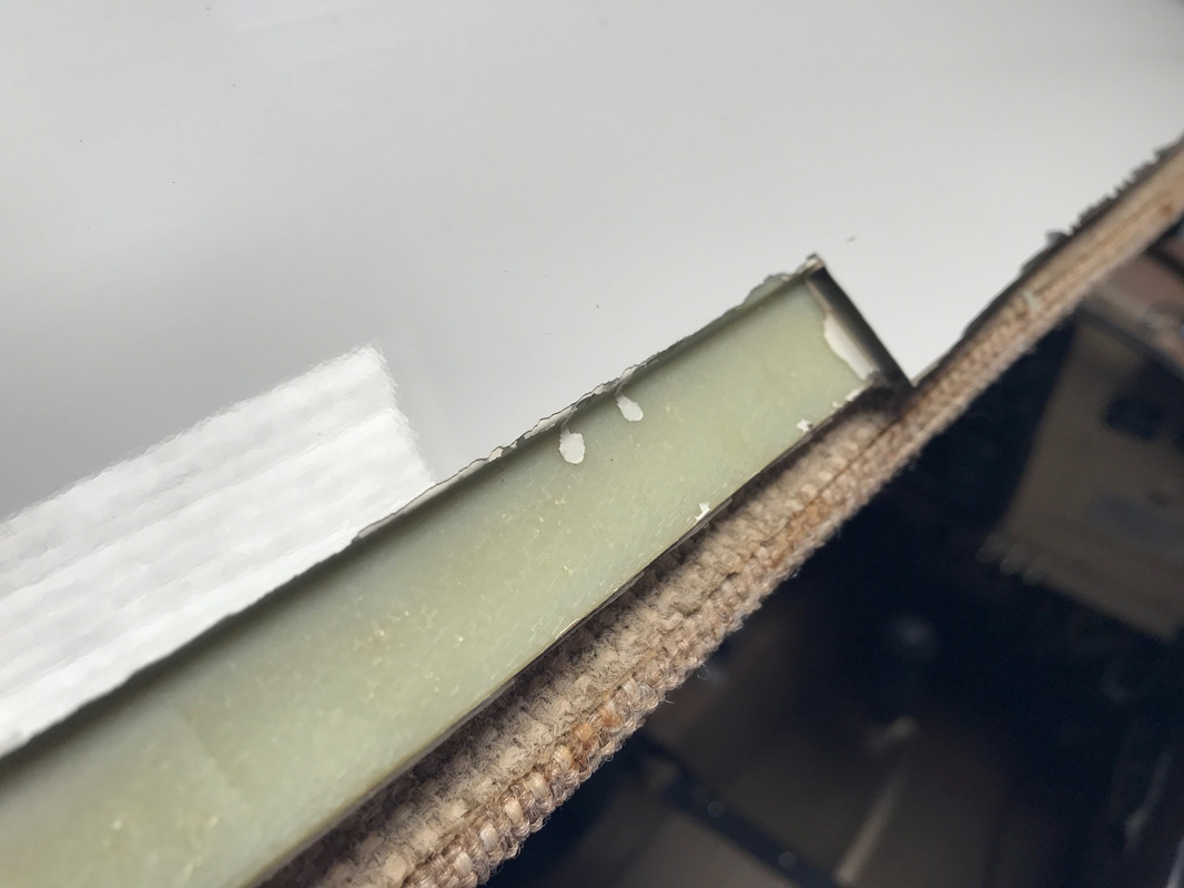

I had a similar problem
About 2 years ago, I noticed the my back windows were separating and debonding from the canopy. Thank goodness I had the foresight to recognize that this can separate and I had the windows removed rebonded , fiberglassed and painted by a guy with lots of experience in fiberglass. I did not build my 10, so I wanted to get someone with experience. Sorry you had to go thru this scary experience, but I must say I?m proud of myself for recognizing this and being pro active about it.
Ted Chipps
Rv10 498EC
That's a bit different than my situation. I had the expansion/contraction cracks at the corners but no separation or debonding that was apparent until the window departed. The cracks were the same as they had been for the 5 years I have owned it. No difference in height with the surrounding fiberglass or widening of the cracks over the years. But I'm glad you saw yours debonding and got them fixed!

I am also a believer that the large differences in the thermal expansion rates of the plexi vs F/G requires an adhesive that provides some flex to support those differences. Think the world of Van's but believe they got it wrong in specifying the weld on adhesive. It is simply too rigid with very little give for this application. Even the Weld on tech said it was a bad fit and recommended a different adhesive that was more flexible. Instead, look to the marine industry that regularly adheres plexi windows into F/G frames/structures.
I used sika 290 (the gold standard in marine window adhesive) and you wouldn't believe the amount of expansion and contraction that I have observed in the seams (goes from aggressively concave in cold to aggressively convex in heat). If that were rigid adhesive, every event would be trying to shear the adhesive off. No wonder we have seen the windows depart unless the bond is near pefect.
