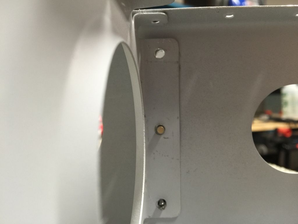

I'm pretty embarrassed about this but for the life of me, I cannot figure out how to drive these rivets. Nothing I have at my disposal can get into this tight location. I've driven at least 8 rivets into these three holes On my vertical stabilizer and each time I have to remove it. Now the holes are a little larger and I'm thinking I need a new inspar rib.
I have a 3x rivet gun and a pneumatic squeezer.
Any suggestions for a newbie who obviously needs to put this down for the day and have a few beers.
