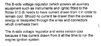

If you are building a 12iS, don't skip the lights
jrtens
Friend
You will need them on hot days to keep the voltage regulator from overheating. (Yep - the exact opposite of the 12)
See the attached explanation from the 12iS FTS about one of the big electrical differences from the 12.
After the battery is topped off - and that happens rather quickly - I regularly see 7 amps without the lights.
That’s really weird. You would think the voltage regulator circuit would modulate the field windings to match output with load.
What if you had to drive your car around all the time with headlights, radio, and turn signals on?
The Rotax alternators are permanent magnet type. Thus they do not have field windings.
I can not believe that, "These regulators reject any unused electrical power
as heat
." Van's must have been misinformed about this. What Rotax
document is this statement based on? Suppose that 21 amps are available but
not used by the aircraft. If those 21 amps were turned into 300 watts of heat,
how is that heat dissipated? Where are the cooling fins?
It will be easy enough to test. Put a thermocouple on the voltage regulator and go fly.
Observe the thermocouple temperature first with a light electrical load, and then with
a heavy electrical load. Repeat a few times to be sure the numbers are consistent.
Permanent magnet alternators will either have a shunt type VR or PWM VR.
The shunt type WILL dump the excess amps as heat.
It is true that there are shunt type voltage regulators. But a shunt type can not
possibly be used with the Rotax iS. The Rotax iS generator output is rated at 420 watts.
A shunt type would need to be capable of dissipating 400 watts of heat. How is
that possible when the regulator is not much bigger than a pack of cigarettes?
The regulator is rated at 80 degrees C. If it had to dissipate 400 watts, it would
get as hot as a milk house heater. Why would Rotax design the voltage regulator
with old shunt technology instead of the new switching type? Well, they didn't.
The smaller the electrical load is, the cooler the regulator will be.
The voltage regulator does not care if the landing lights are on or not.

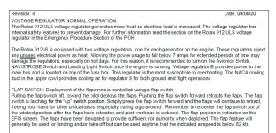

The fact that Vans guidance goes against conventional thinking, as you have pointed out, makes it hard to imagine that they put it in the FTS without some research and testing.
With a quick search, I found a 2016 Sling LSA safety advisory recommending the same - to turn on the lights to keep the B regulator from overheating.
Here is a note from that SA.

A regulator takes an incoming voltage and produces a stable output voltage, the difference between those two voltages is the heat produced.
The current produced by the alternator is based on load, it will only supply a load based on the demand. It doesn’t just produce 40 amps at all times.
The PCM controlled alternator on cars is so that when cruising in a high gear and low rpm the alternator is able to produce sufficient current to match the load and you don’t get a parasitic draw on the battery.
Today I was a passenger in my friend's Kitfox that has the same engine as a RV-12, a Rotax 912iS engine.
We had installed a thermocouple on voltage regulator B to monitor its temperature which is displayed on the Skyview HDX screen.
While cruising, I pulled the circuit breaker for Regulator B which disconnected it from the aircraft main power bus. The aircraft battery was now supplying aircraft electrical loads. We watched regulator B temperature which was 80 degrees F prior to pulling the breaker. Over a period of about 5 minutes, the temperature slowly dropped to 75 degrees F. The outside air temperature at our altitude was 54 degrees F. To prevent any voltage surges, my pilot friend reduced RPM to idle while I pushed the regulator B circuit breaker back in. We watched the Regulator B climb back up to 82 degrees, a little warmer because the battery was being recharged.
Conclusion from the experiment:
The temperature of regulator B goes down as aircraft electrical load is reduced.
Page 6-6 of the RV-12iS Flight Training Supplement is incorrect when it states, "These regulators reject any unused electrical power as heat. Allowing the power usage to fall below 7 amps for extended periods of time may damage the regulators."
