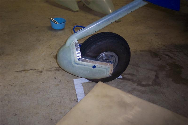

I haven't built a -12 (yet) but I continue to give it heavy consideration. The only part of the airframe I don't care for is the style of the lower cowling. Is there a way that could be changed to improve the looks a little?
also, no one has mentioned wheel pants yet. More complexity with no real gain?
Wheel pants
Pictures in this forum;
Wheel pants
Amen - Rudy
You are right on, man.
