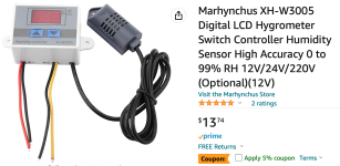

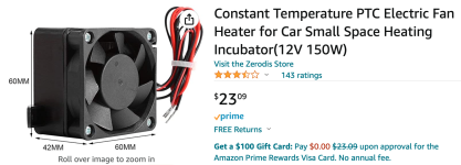

Canopy is closed when airplane is in hanger. I’m thinking about adding a small (150W 12V) space heater inside the cabin to be controlled with a humidity switch. Space heater and humidity switch would be located in closed cabin – both low voltage DC for safety.
Anybody doing this?

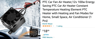

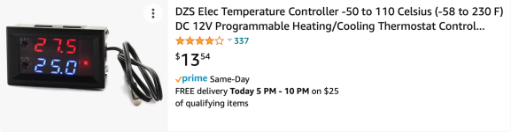

I’m still looking at options to heat cabin interior to prevent condensation. I found a 12V 100W heater with a small fan that might do the job.
My PC680 battery is connected to an Odyssey OBC-6A battery charger 24/7 whenever the airplane is in the hanger. I can easily run this heater off the airplane battery and the charger will top off as necessary. A small 12V temperature controller can be set for 70F shutoff. The heater would be fused for safety…

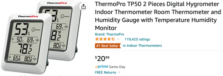

I’m still working this problem and have decided to just monitor the situation before taking any action... I just ordered two recording temp/humidity sensors and will place one in the airplane cabin and leave one out in the hanger. By comparing the two stored temp/humidity readings I should be able to tell if the cabin is getting condensation. It’s a starting point…
