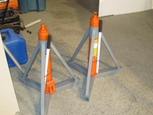

Phil, the jacks were about $40 each at Harbor Freight, some scrap iron plates were about $5 each.
I used a piece of 2x6" under the spars, drilled a shallow pocket in the wood to capture the top of the jack ram.
Less than $100 total, and always available for use as needed during annual inspection, tire or brake repairs etc.
The tail was tied down to a ring in the floor, and used to counter balance the weight of the nose, to achieve a level attitude.

I did the same as Mike.
For a tail weight, this is a dolly with a sheet of plywood and an eye ring. Just add a few pounds of concrete.
A friend of Geoff welded the stand for me. With the 20% off coupons from Harbor Freight, the cost wasn't bad. You're going to need them down the road anyways.

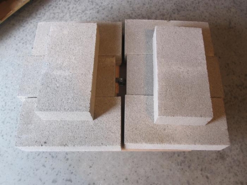

I've got mine sitting level on blocks and the mains are about 4 inches in the air, the nose isn't quite that high. I'm going to tweak it a bit more tonight before starting to fit the pants.

I believe this gets it.
It appears that I might have a .2 to .3 degree twist in the mid fuse section based on discrepancies between the left and right mid fuses. It's a QB fuse and not enough to worry about. But it is a little frustrating when you have a digital level and you built the tailcone to have 0.0 degrees of twist. :eek:
Now I can get busy putting the pants on in the evenings.
