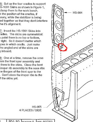

I'm clecoing together my HS ribs for the first time, and I know these holes don't get drilled until the skins are on, but I'm seeing something that just doesn't line up.
The holes on the front of the HS inspar ribs are about a half a hole behind the holes on the spar flange.
I read that some others had this issue (some on other RV models). Some final drilled the parts separately, and some mentioned that clecoing the skins on would push everything into place.
This is the hole in question (and all the other HS-904 ribs are about the same, the HS-1004 ribs are better, but still not perfect).

Things have been popping right together so far in the kit, so going forward I just need an idea of how much I should be "massaging" things into place.
Thoughts?
