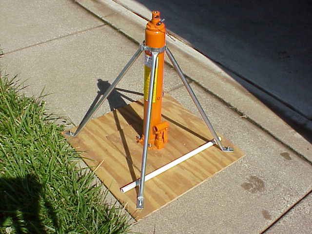

Having just discovered the bolt guage a couple of weeks ago (now I don't have to measure the length and grip of ea. AN3,4,5,&6 bolt), I would hope to learn how to jack up the RV-12 without destroying it. I lifted the plane by hand yesterday evening (one main gear at a time) while my wife slipped the main landing gear wheels on their axels. I'm getting too old for that method.
Harbor Freight has a few jacks ... which one and any tricks of the trade?

With the wings attached you can use the tie down points as jacking points.
The 3/8"x16 cap screw is shaped to fit into a counter sunk hole in the top of the jack.
Just screw the cap screw into the wing and place the jack under the wing and off you go.
To raise the nose wheel add weight to the tail tie down then jack up the wing.

I'll go to Harbor Freight for the jack and Wicks for the Bogart pad. Thanks
