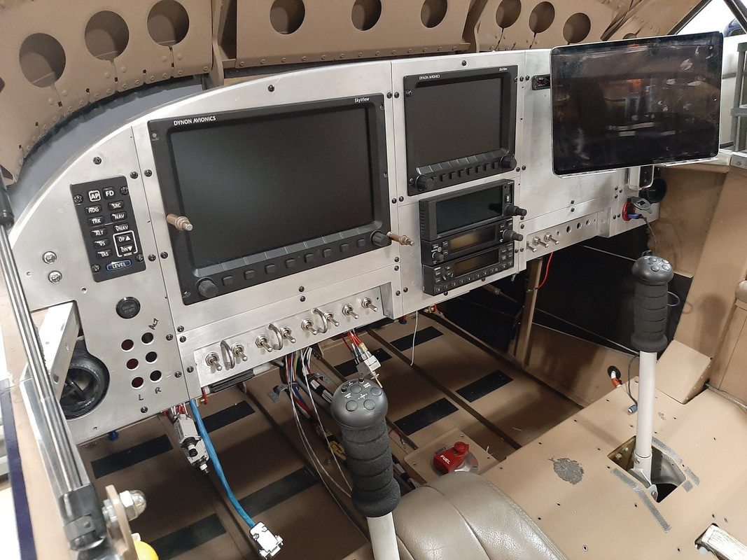

I’m halfway through the same process here in Toronto.
I had my design approved by my inspector before cutting metal.
Many thanks, I may be giving you a call sometime over the next few months if you don’t mind,
Simon
The panel so far....

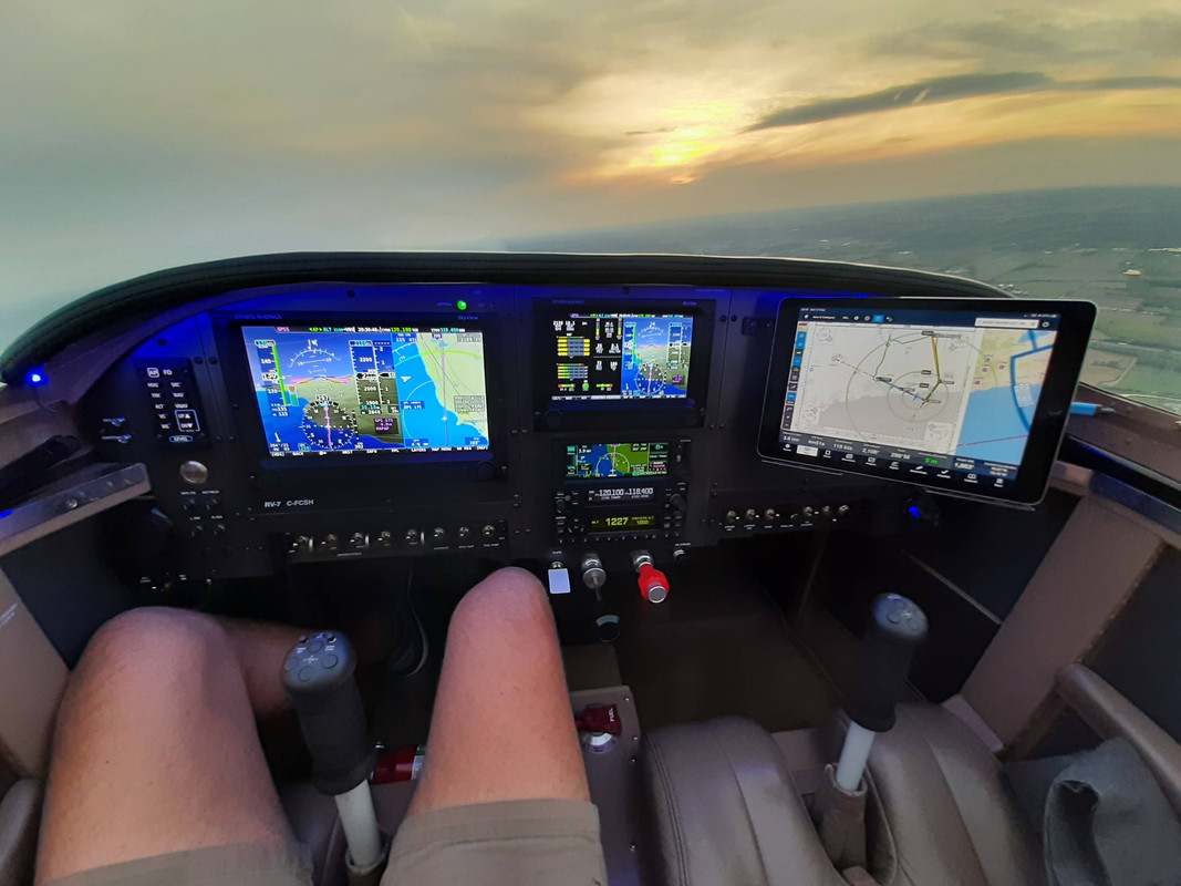

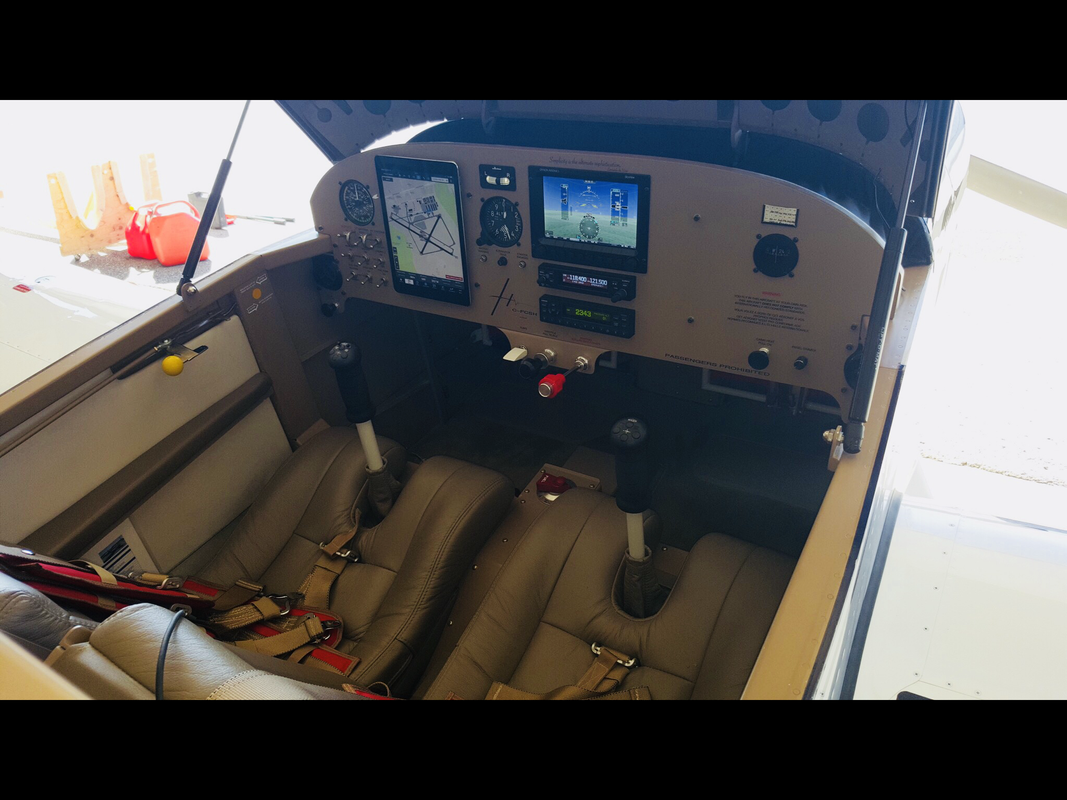

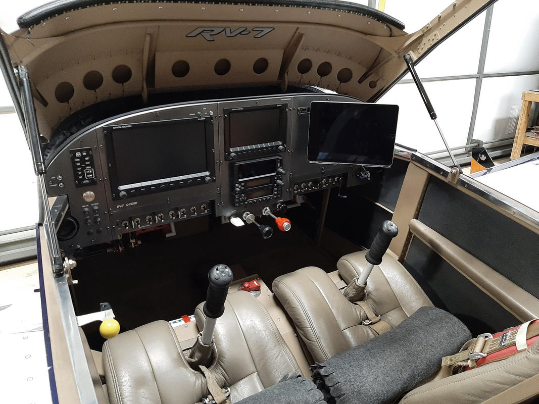

Finished IFR Panel
Hi guys, just wanted to post the final photo of my upgraded Canadian IFR panel.
Yes I do have a E2B compass, behind the IPAD, never used it and probably never will.
Thanks Claude for some ideas of what the TC inspector wanted to see in terms of paper work. I found transport Canada to be very efficient, it was just a paperwork exercise.
Happy flying ,
Before and after photos. 500 hours and a few months of work.
Looks great Simon. What are you using as your second navigation source? I don't see anything on the panel.
Do you have problems with the iPad overheating in flight with it being that exposed?
