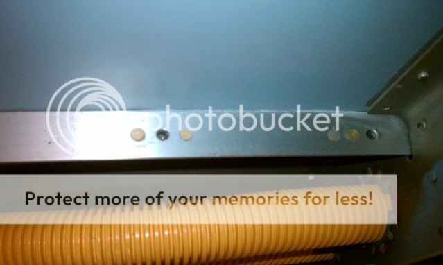

How did you rivet these nutplates in?
jtrollin
The arrow on the right points to a nutplate you cant see on the diagram, I can get one rivet, but not the one closest to the support going up at an angle.
nutplate pop rivets
Van's sells nutplate pop rivets. If the stiffener is too thick for the ones Van's sells, then you can get longer lengths from Bonaero.
CCR264SS-3-2 or CCR264SS-3-3
Vise Grips and scrap aluminum did the trick
So I used some Vise Grips and scrap aluminum I had around the shop and it worked great. Thanks for all the tips!
For the archives and to benefit someone's search on the topic, Van's QB factory has single leg nut-plates installed.
