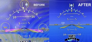

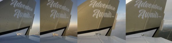

I have solved this.
Steve, I want to thank you for the suggestions to cover the leak holes and to decrease the bend angle. I owe you a few drinks at Starbucks. Want a gift card? Doing those things, plus adding a 1.25" extension to the bottom 10-inch section has finally resulted in flying coordinated. I also reduced the bend angle in the aileron trim tab. Now it flies straight again! Interesting that I needed these modifications after installing the new prop, but it works now and that's what matters. I don't like the tape to cover the holes, so I'm going to cut and bend a new piece of sheet metal to match the final configuration I have here, get it painted, then have my A&P replace the trim tabs with the new ones that don't have the holes in them.
For whoever is interested, I tried multiple configurations and made about half a dozen test flights before finding this final configuration that worked and got the airplane flying coordinated in cruise again, for the first time since the new prop was installed. See attached photo showing four of the different configurations tried.
