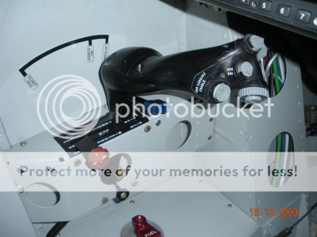

Looks nice... but if you end up flying from the other seat, you might appreciate something a bit more symmetric.

That throttle looks pretty cool. I have more buttons and controls on mine than I could possibly use, but I my only regret is that I only hooked up my flaps on the throttle. If I had it to do over (or wanted to tear it all apart and use another button), I'd have wired my electric fuel pump to one of the switches. It's a pain to have to reach over to the right switch panel to activate the pump ...
Good eye! And first one to catch it. I literally tried everything from drill guns, to hammers, various tools, pistol grips, automobile shifter grips, motorcycles, bicycles, tennis racquets, everything, even went into the kitchen and cut into one of my wife's favorite cooking ware items (still in the dog house). Finally came back to rifle grips, and voila! Just enough room for electronics up top and you don't get a better tactile/comfort feel than that grip. Super heavy duty -- I've bashed the **** out of it, drilled through it, heated it up, and it holds beyond description (well, guess it should considering it's original design purpose.) The pistol grips were close, but not enough up top for the entire hand. Working with Hogue now in making some slight modifications, and adding "FATBOY" up the backstrap. Also working on a stubbier version for prop lever. The RV8s are tight laterally, so this might not work having 2 FatBoys side by side, so with a stubbier version tucked under the throttle grip? I have a guy in FL that I sold 2 FatBoy grips/levers that will be doing both prop and throttle in a Pitts Model 12.

That F16 grip is amazing. So what does the afterburner feel like in an RV-8?
Thanks for the positive feedback, fellas. Getting a quadrant right is a moving target -- different airframes, "pilot" frames, panel positions, cable positions, grips, knobs, travel restrictions, vertical/horizontal restrictions, knob/grip clearance, it all adds up, so I'm always looking for feedback and suggestions.

...That F16 grip is amazing. So what does the afterburner feel like in an RV-8?...
Andy, because I'm too cheap to pay to push it into burner very often or for very long, it pretty much feels like an IO-360 most of the time. :D
I'd like to see the guts to that throttle grip. Are you using most/some of the switches? The closest thing I have to an F16 TQ is a Thrustmaster (remember them back in your PC flight sim days)?
