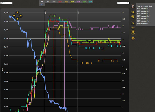

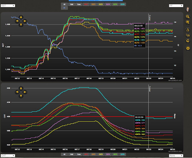

Hopefully the Savvy image attaches correctly. This data was from a normal cruise climb on one of the short trips we did and shows the leaning from ROP to LOP duration.
You can see the FF in relation to EGT's during leaning and the CHT's in the lower half of the graph.
Then the graph below the first is the Gami spread.
Is there something I'm not seeing?
And here is the GAMI spread:
Those GAMI spread lines are kind of arbitrarily placed by the software. Look at the chart instead. To me it looks like it peaks at 13.5 or so.
I'd do a couple more runs to confirm though, level 24/24, stop every .2gph for a few seconds for the numbers to settle.
You have about the same CHT delta when LOP. So it may still be a cooling airflow issue.

It appears to me you may be leaning to rapidly to get good data. Note how some CHT's appear to be still rising until :18.5 when there was a sudden drop of 1 gal/hr in FF. (If CHT's are rising you must still be ROP).
