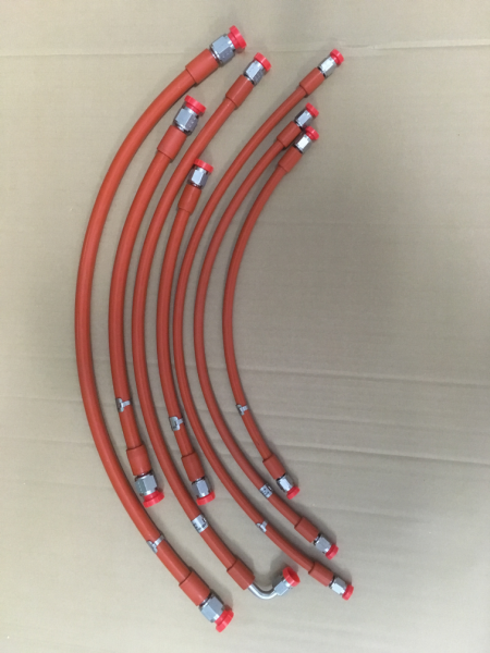

To add to the discussion..... as Tom mentioned, Vans has been utilizing teflon hoses for awhile FWF.
Fuel supply lines from Vans are typically a quality Conductive Teflon hose and are firesleeved. Oil lines are a quality non firesleeved Conductive Teflon hose. Oil Pressure, Fuel Pressure, and Manifold Pressure lines from Vans are typically a non firesleeved, non conductive teflon hose and the fittings are imported industrial fittings with a plated coating.
Here is a stock picture of a FWF hose kit from Vans
Tom and I choose to utilize conductive teflon hoses for ALL FWF lines. We also firesleeve ALL hoses FWF (except for certain Manifold pressure line applications/PMAG Manifold Pressure Line Applications). ALL hoses have the same quality 100% stainless steel fittings and stainless steel collars which means that you won't start to get surface corrosion on the fittings over time. In addition, every hose we build has a 10 year warranty, and they are all "on-condition" replacement items. Finally, builders have a choice of either standard Milspec AS1072 Firesleeve, or our new Premium Integral Silicone Firesleeve option. (Pictured Below)
