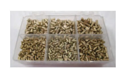

I would try using an oops rivet. In case you haven’t heard of these, a -4 oops rivet has a -4 manufactured head and a -5 shank.
NAS1242AD is a 1/64" oversize rivet for MS20470AD. NAS1241AD is 1/64" oversize for MS20426AD rivet. Drill #.27
http://www.skybolt.com/catalog/034 Solid Rivets-Aluminum.pdf
Thanks, Bill. I've got the 1097s but not the 1242s. I think the hole might need more than 1/64 expansion but maybe not. The link to Skybolt was a File Not Found on their main page. When I searched for the 1242 it drew a blank. I've found them other places, but so far only by the pound, which would be overall. I'll keep looking.
