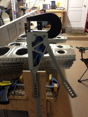

Helpful tool "add-on"
jlfernan
I shamefully stole this idea from another builder's website but found it so helpful, I thought I would put it out there for the world to see. It simply holds your rivet squeezer to allow you to hold the part you're riveting with your other hand. It provides good control without having to resort to some of the contortions I've seen while riveting parts. It works, I think, with all rivet squeezers.
The rivet squeezer also can be clamped in your bench-top vice at many different angles, depending upon your need.
